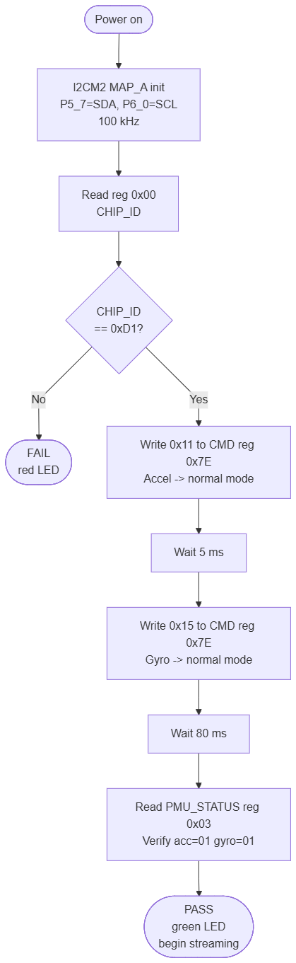

Initializing the I2C
const sys_cfg_i2cm_t cfg = {
    .clk_scale = CLKMAN_SCALE_DIV_1,
    .io_cfg    = IOMAN_I2CM2(IOMAN_MAP_A, 1),   /* P5_7=SDA, P6_0=SCL */
I2CM_Init(MXC_I2CM2, &cfg, I2CM_SPEED_100KHZ);
So here is the final flow
and the code equivalent to that
static int bmi160_init(void)
    uint8_t chip_id = 0;
    /* 1. Verify chip identity */
    if (bmi160_read_regs(BMI160_REG_CHIP_ID, &chip_id, 1) != E_NO_ERROR)
        return E_COMM_ERR;
    if (chip_id != 0xD1)
        return E_BAD_PARAM;
    /* 2. Wake accelerometer */
    bmi160_write_reg(BMI160_REG_CMD, 0x11);   /* ACC_NORMAL */
    TMR_Delay(MXC_TMR0, MSEC(5));
    /* 3. Wake gyroscope */
    bmi160_write_reg(BMI160_REG_CMD, 0x15);   /* GYR_NORMAL */
    TMR_Delay(MXC_TMR0, MSEC(80));
    return E_NO_ERROR;
This will help make the IMU ready to stream the data.

    saramic  I used flowchart image straight out of mermaid. and thanks to your comment to use gif. I've added that. I am using Kden to make the gif though.
