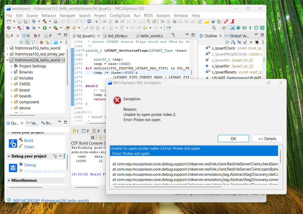

I’m still having problems with the MCXN236 . Can't find the probe
CONSOLE log:
LinkServer RedlinkMulti Driver v25.6 (Jun 26 2025 19:34:05 - crt_emu_cm_redlink build 1017)
Found chip XML file in C:/nxp/workspace/frdmmcxn236_hello_world/Debug\MCXN236.xml
( 5) Remote configuration complete
Reconnected to the existing LinkServer process.
Connecting to probe 2 core 0 (using server started externally) reports:
'Ee(42). Could not connect to core.'
Retrying...
Server OK but no connection to probe 2 core 0 (after 3 attempts) - Ee(42). Could not connect to core.
Failed on connect: Ee(42). Could not connect to core.
No connection to chip's debug port
 I'm dead in the water with the MCXN236 and can not develop my project without it Does any one know why thus is happening? Is my board defective?

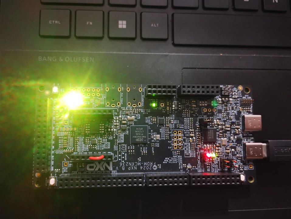

    skruglewicz 11 months ago +3 verified
    UPDATE STATUS on the problem Success What was the reason? Turns out there were multiple versions of the MCU-Link firmware on my troubled PC. And as I found two Common Causes of Persistent Debugging…

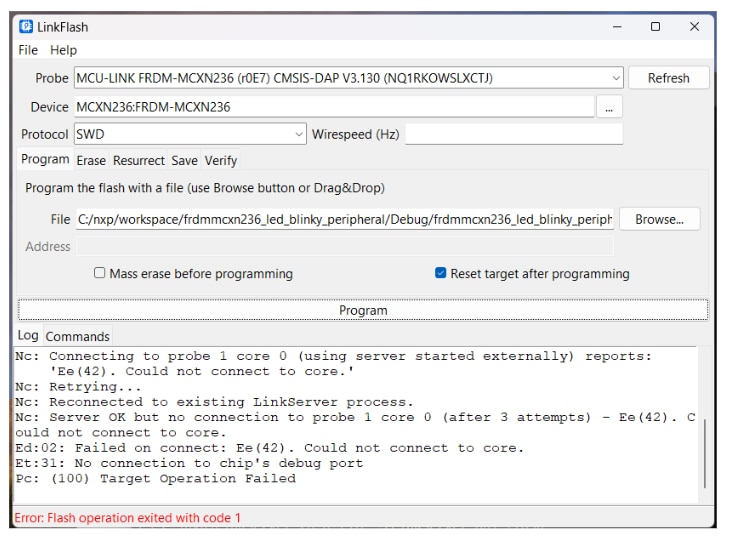

  • skruglewicz
    0 skruglewicz 11 months ago in reply to balajivan1995
    balajivan1995 said:
    2. Sometimes the IDE will hang trying to open the linkserver. In that case, close the IDE, locate the axf or hex file and flash it using standalone link flash application.
    UPDATE I found the location of the .axf file and ran the LinkfFash and received a similar error
    Nc: Connecting to probe 1 core 0 (using server started externally) reports:
    skruglewicz said:
    Also, do you think I need to update the MCU-Link firmware using the firmware update utility for my board? Wondering if that might be causing problems with the debug port not connecting.
  • balajivan1995
    0 balajivan1995 11 months ago in reply to skruglewicz
    Hi, sorry for the late reply. I have attached a n236 board project file that will automatically toggle the RGB led. You can compile with your own IDE or use the .axf file directly. Can you please flash with this file?
    n236_led.zip
    Also, please ensure you have connected to the correct USB port.
