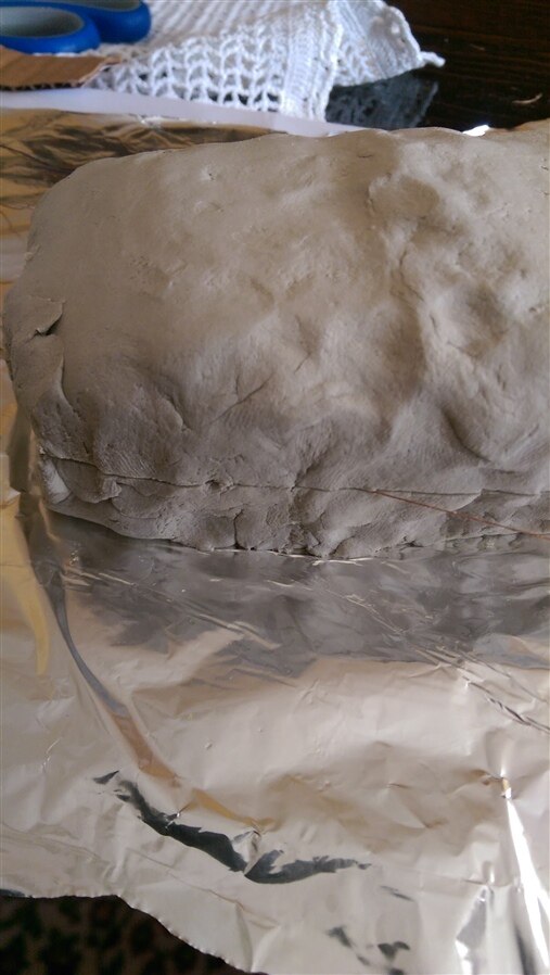

Making the mold

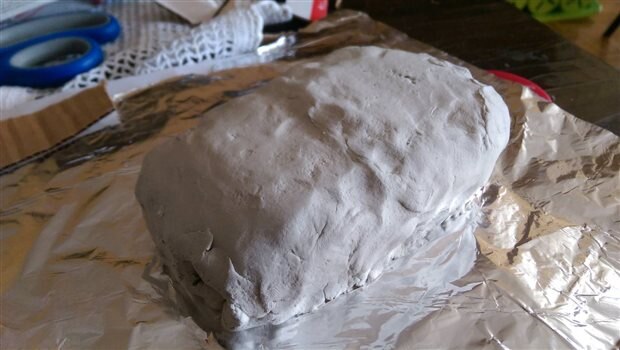

I started out with some school clay. It was used to make a mold. This kind of white clay dries very quickly, especially if you put your mold into oven for a couple of hours (I set it to heat up to 50C). I made a hole inside this peace of clay that should fit my remote sensor unit easily.
With a sawing thread I split this blob into two pieces.

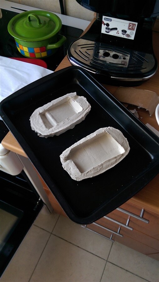

Two pieces are then placed in the oven to dry and become solid. I didn't make a horizontal cut evenly so it looks like the holes are skew - they should be fine when put back together.

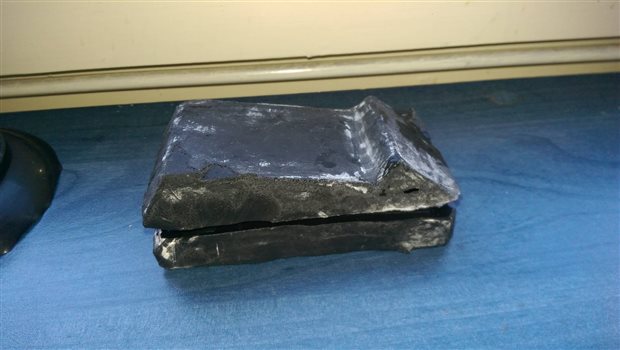

Casting the PU resin

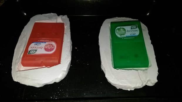

I placed the TicTac boxes to make the inner bound for PU resin. Small spacers are visible through these boxes. These spacers will define the wall thickness. Spacers will leave holes in final PU case.

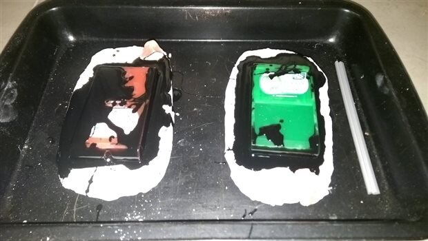

Then I carefully mixed the two PU components and poured the resin into molds. I should end up with two halves of my sensor unit casing after PU resin cures completely and I remove the extra PU.
I did this step late in the evening (or very early in the morning) so I will see the result and continue writing this post in the morning.

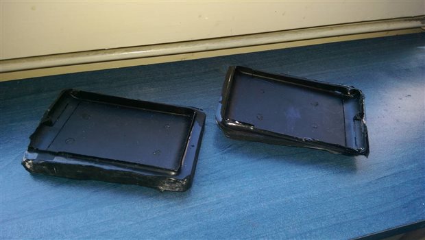

Removing the mold and extra PU
After I removed the clay mold and TicTac boxes I was a bit disappointed. It turned out that resin pulled the TicTac boxes up so I ended up with too tick castings and too shallow to place my board + battery image
However, I do like the Electrolube Resin very much. Too bad it comes in bag and not in two separate bottles, this way I had to throw away the rest of resin.
My intention was to make it look similar to this but much prettier and with enough space inside image

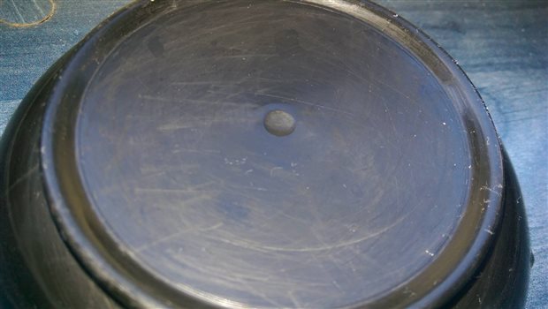

I also made a photo of leftover resin just to show how fine this resin is (click the image to enlarge). If only I had a proper mold, I think that it would have turned great.
Please note that small scratches all over the resin are from a plastic pot where it cured. These scratch marks are really, really fine.
Conclusion
Electrolube PU resin is great (if you have a proper mold)! I will use TicTac box instead...

    mcb1 over 11 years ago
    Excellent review.
    Shame it didn't work for you.
    As you said it is usually poured over the components to prevent damage from movement, and with smd this is as necessary.

    tomaja over 11 years ago in reply to shabaz
    Haha, thanks! image
    I think that some silicon/rubber based mold would do a great job. Some youtube videos suggest that it's a good idea to have a nice positive that you use to create the mold. Rubbery mold makes it easy to remove the casting when it's done. Specifications for this resin states that it cures after 36hrs but I think that it was faster (maybe 18hrs) - it greatly depends on the temperature and these last few days were very hot here image
    And yes, I'm amazed by the details that got transferred from my plastic pot, I would like to try it out again one time.
