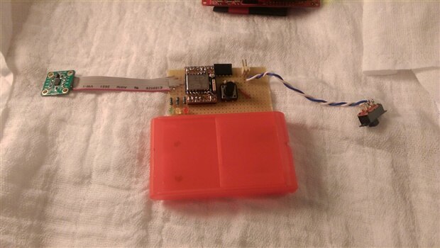

I left the accelerometer reading as my last step since accelerometer module last arrived - I didn't get to the point where I'm reading it since my last ESP8266 board died yesterday! image

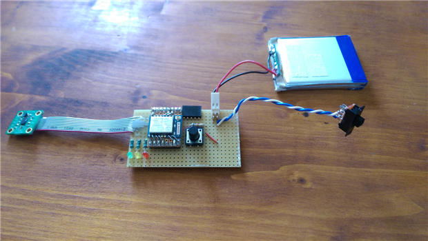

So much time spent on a project and then one moment of not being careful makes it all useless! I connected my board to the battery for a test and forgot to use a voltage regulator (3.3V). This turned out to be fatal for my LAST ESP8266. It works partially but I'm unable to flash it anymore (LEDs blink as if everything is fine but connection with device never succeeds). I order one more board from eBay a while ago just in case something similar happens but it still didn't arrive image
Remote sensor device
Remote sensor device is built around ESP8266 - ESP07 breakout board. ESP8266 runs at 80MHz. This is a small board that makes the entire device small even without making a custom PCB (Due to lack of time I used the prototyping PCB with short lines). Custom PCB with SMD components would be a great improvement.
Figure 1. ESP8266-based remote sensor unit

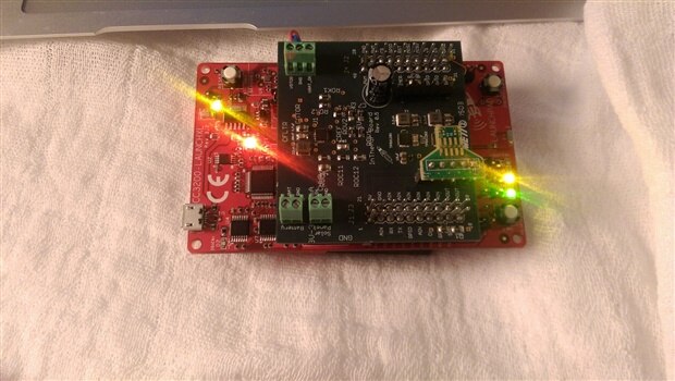

Sudden Impact Monitor Demonstration
Since my original board died suddenly by the voltage impact I had to make some last-minute workaround to be able to demonstrate my client application. So, just for the purpose of making a demonstration video I modified the original sketch just so that it can run on a CC3200 Launchpad and to use the Launchpad's onboard accelerometer. I had a very limited time for this workaround so please take that into account (I did it one hour ago, after I finally gave up on my original board). Anyway, I should receive a spare ESP-07 board any day so I might be able to send it with my original device and let the Leeds Becket guys fix it in that one day period that's available for fixing.
Figure 2. CC3200 Launchpad as a workaround for the demo video
