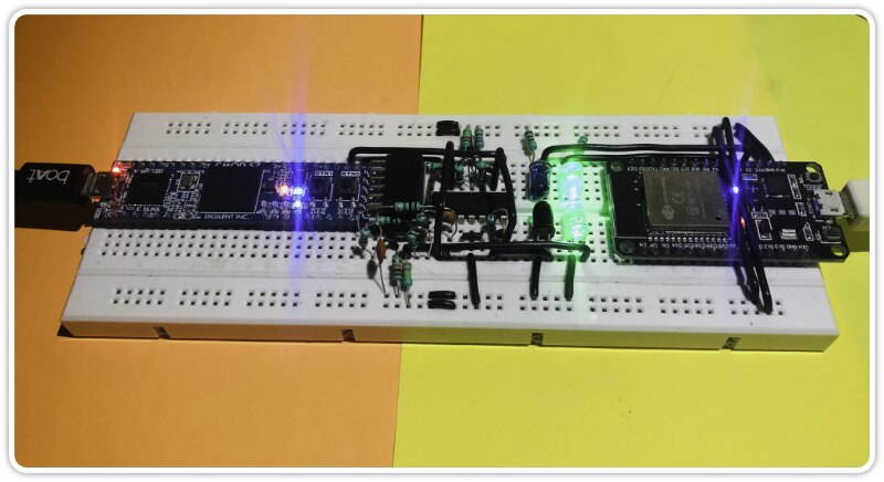

This is the final blog for the "Summer of FPGA" challenge.
My aim for this one is to explain most of the technicalities of how the Peripheral is designed and built. At the end of this blog, I would be giving my opinion on the tools I used and the overall experience and skills I have garnered since. I would also like to state and describe some features that I would have liked to have added before the deadline.
So without any further delay, I give you LiFi in the flesh...
Modules
I divided the whole unwrapping process into separate modules, such that each part of the frame could be processed and on successful execution, the baton (packet) gets passed on to the next module until the STOP.

ESP32 testbench
So to test the LiFi peripheral completely assembled I had to setup a transmitter, and that's exactly what I did. You can find the code on my GitHub repo here. The code is pretty straightforward with prompts to enter the message. The only IO connection is to the LEDs and that's pretty much it.

Vitis Demo
I have to be honest here, I hate Vitis, I really do. It's infuriating how much of a downgrade this seems to SDK and I used SDK after using Vitis.
Regardless, I set up the unfortunate workspace and created an application project from the exported XSA file which also packages the bitstream. Then I followed through with the polling-based code:
// INCLUDES ======================
#include <stdio.h>
#include <stdlib.h>
#include "platform.h"
#include "xil_printf.h"
// for AXI GPIOs
#include "xgpio.h"
#include "xparameters.h"
// for delay
#include "sleep.h"
// GLOBAL VARS ===================
// declare XGPIO objects
XGpio status_reg;
XGpio status_reset;
XGpio config_writeonly_reg;
XGpio config_readonly_reg;
XGpio received_ID_reg;
XGpio data_reg[4];
// variables to hold the register data
u8 status;
u16 received_id;
u16 config;
u32 data[4];
// HELPER FUNCTIONS ====================
// to read the status register
void readStatus() {
	status = XGpio_DiscreteRead(&status_reg, 1);
// to read the configuration register
void readConfig() {
	config = XGpio_DiscreteRead(&config_readonly_reg, 1);
// to read received ID register
void readReceivedID() {
	received_id = XGpio_DiscreteRead(&received_ID_reg, 1);
// to reset the status register
void resetStatusRegister() {
	XGpio_DiscreteWrite(&status_reset, 1, 1);
	usleep(5);
	XGpio_DiscreteWrite(&status_reset, 1, 0);
// get the data from the buffers
void getData() {
	for (int i=0; i<4; ++i)
		data[i] = XGpio_DiscreteRead(&data_reg[i], 1);
int main() {
	// start platform
	init_platform();
	// Welcome screen
	print("\r\n================== LiFi Demo ==================\r\n");
	// ========================= INITIALIZE REGISTERS =========================
	// Initialize the status register and status reset
	XGpio_Initialize(&status_reg, XPAR_STATUS_REG_DEVICE_ID);
	XGpio_Initialize(&status_reset, XPAR_STATUS_RESET_DEVICE_ID);
	// Initialize the configuration registers
	XGpio_Initialize(&config_readonly_reg, XPAR_CONFIG_READ_REG_DEVICE_ID);
	XGpio_Initialize(&config_writeonly_reg, XPAR_CONFIG_WRITE_REG_DEVICE_ID);
	// Initialize the received ID register
	XGpio_Initialize(&received_ID_reg, XPAR_RECEIVED_ID_REG_DEVICE_ID);
	// Initialize the data registers
	XGpio_Initialize(&data_reg[0], XPAR_DATA_01_DEVICE_ID);
	XGpio_Initialize(&data_reg[1], XPAR_DATA_02_DEVICE_ID);
	XGpio_Initialize(&data_reg[2], XPAR_DATA_03_DEVICE_ID);
	XGpio_Initialize(&data_reg[3], XPAR_DATA_04_DEVICE_ID);
	// ========================= SET DATA DIRECTION ===========================
	// inputs
	XGpio_SetDataDirection(&status_reg, 1, 0xFF);
	XGpio_SetDataDirection(&config_readonly_reg, 1, 0XFFFF);
	XGpio_SetDataDirection(&received_ID_reg, 1, 0xFFFF);
		XGpio_SetDataDirection(&data_reg[i], 1, 0xFFFFFFFF);
	// outputs
	XGpio_SetDataDirection(&status_reset, 1, 0);
	XGpio_SetDataDirection(&config_writeonly_reg, 1, 0X0000);
	// configure the peripheral to operate in AUTO mode
	resetStatusRegister();
	XGpio_DiscreteWrite(&config_writeonly_reg, 1, 0x395C);
	readConfig();
	xil_printf("Configuration Register Set To %04x\r\n", config);
	// start loop for polling
	while (1) {
		readStatus();
		if (status & 0x40) { // if received triggered
			u8 length = 0x0F & status;
			xil_printf("STATUS register: %02x\r\n", status);
			xil_printf("DATALENGTH: %d\r\n", length);
			readReceivedID();
			xil_printf("RECEIVED ID: %04x\r\n", received_id);
			getData();
			xil_printf("DATA buffer: %08x %08x %08x %08x\r\n", data[0], data[1], data[2], data[3]);
			for (int i=0, j=-1; i<(length-1); ++i) {
				if ((i % 4) == 0)
					++j;
				xil_printf("%c", (char)((data[j] & (0xFF << (8 * ((3-i%4))))) >> (8 * (3-(i%4)))));
			print("\r\n\r\n");
	// conclude platform
	cleanup_platform();
	return 0;
This is essentially the only piece of code I did modify after the deadline, this is because the original demo would only show the first data field register and it wouldn't even translate it to ASCII, which doesn't make for a good demo. This one on the other hand is much better, reporting all the necessary information about the peripheral. It would have been better with the ISR (Interrupt Service Routine) but I digress.
An important note, the softcore block must be configured with large code memory for this demo to work, this is because the xil_printf library has a larger memory requirement, and I learnt that the hard way.
The demo:
Conclusion & Thoughts
