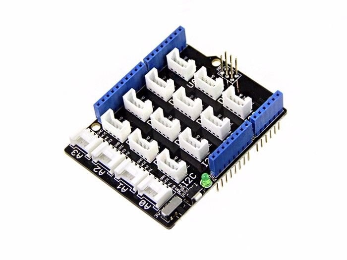

Grove Base Shield
Base Shield provides a simple way to connect with Arduino boards and helps you get rid of breadboard and jumper wires. This shield is used here for connecting Wemos D1 mini with the Arduino through UART.
Official link: https://www.seeedstudio.com/Base-Shield-V2.html

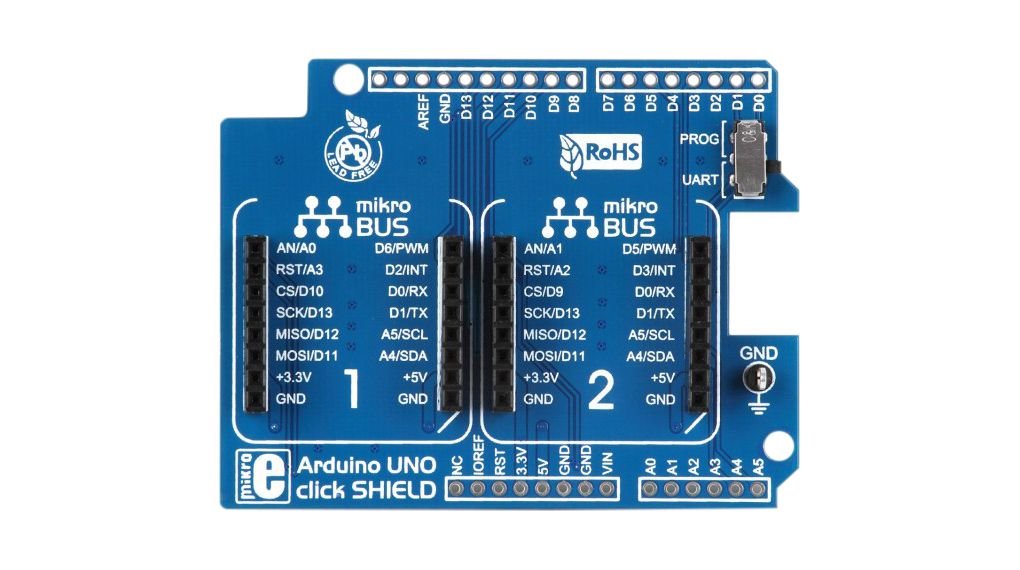

Arduino Uno click shield
Arduino Uno click shield is an extension for Arduino Uno and any other Arduino-compatible board. It's a simple shield with two mikroBUSTm host sockets that allow you to connect more than 1291 different types of Click boardsTm to the Arduino. We connected Mikroe Oximeter 5 Click and ECG module through the click shield.
Details of the shield: https://www.mikroe.com/arduino-uno-click-shield

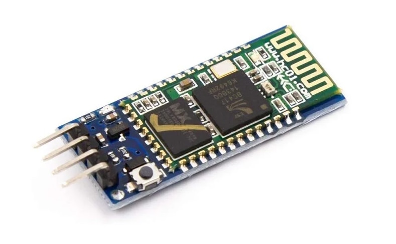

HC-05 Bluetooth Module
The HC-05 is a popular module that can add two-way (full-duplex) wireless functionality to any electronic project. You can use this module to communicate between two microcontrollers like Arduino or communicate with any device with Bluetooth functionality like a Phone or Laptop. There are many android applications that are already available which makes this process a lot easier. The module communicates with the help of UART at 9600 baud rate hence it is easy to interface with any microcontroller that supports UART. This module can be configured to operate as Master or Slave mode. I am using it as a slave device for the main unit.
Details of the module: https://howtomechatronics.com/tutorials/arduino/arduino-and-hc-05-bluetooth-module-tutorial/

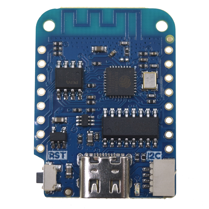

Wemos D1 Mini
Wemos D1 Mini is an ESP8266-based development board with built-in wifi. I used it here for sending sensor data to the cloud server through wifi.
Details: https://www.wemos.cc/en/latest/d1/d1_mini.html

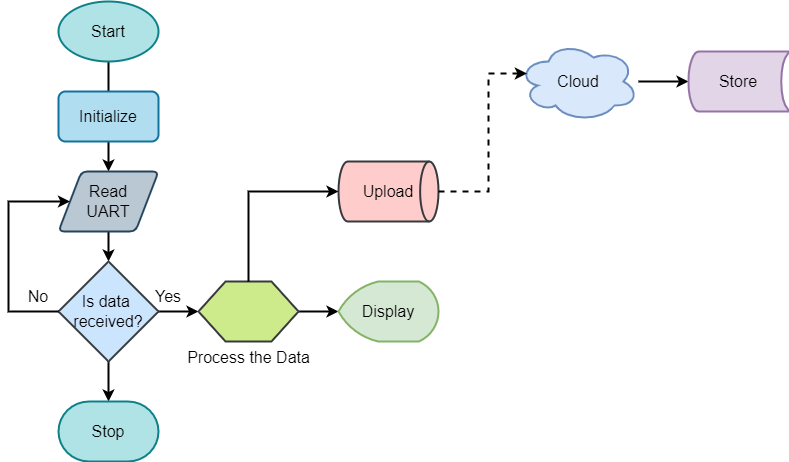

This unit receives the sensor data from other units. It collects the data from the wearable unit using Bluetooth and from the main sensor unit through UART. After getting the data it performs simple processing. After that, it displays the data to the graphics TFT display and uploads the data to the cloud server. Cloud server stores the data as well as visualizes the data in a graphical dashboard. Health concerns and doctors can observe the data and can perform further analysis if required.
For uploading the data to the cloud we need any sort of internet connection. WiFi is a good option that provides a portable solution and is cost-effective. Lots of low-cost WiFi module is available that can be programmed with Arduino. I am going to use one of the most popular and maker-friendly WiFi chips named ESP8266. Based on this chip hundreds of development boards were made. Wemos D1 Mini is one of them with a small form factor and includes a built-in programmer.
The schematic for the second unit is as follows.
Two units are connected through Grove UART cable. As Wemos D1 mini operates at 3.3V, so I converted the output voltage from the Arduin TX pin by a resistors voltage divider to make it compatible with the Wemos board. The hardware unit looks like below:
Sketch for Wemos D1 Mini
The job of the firmware program of Wemos D1 Mini is to gather the data from the wearable unit and from the main unit, display the data to the TFT and upload the data to the cloud. The algorithm of the firmware is illustrated by the following flowchart.
The firmware code for Wemos D1 Mini is attached below. For the successful compilation of the sketch, you will require QDTech_8266 TFT library with the Adafruit_GFX library. You can download the library from the GitHub repository. The library is here. Two UART port is required for the operation. Wemos has one hardware serial. So another software serial is implemented using the Arduino SoftSerial library. Bluetooth module is connected through the software serial that receives data from the wearable unit. For the Blynk cloud connection, you need to add blynk library from here.
