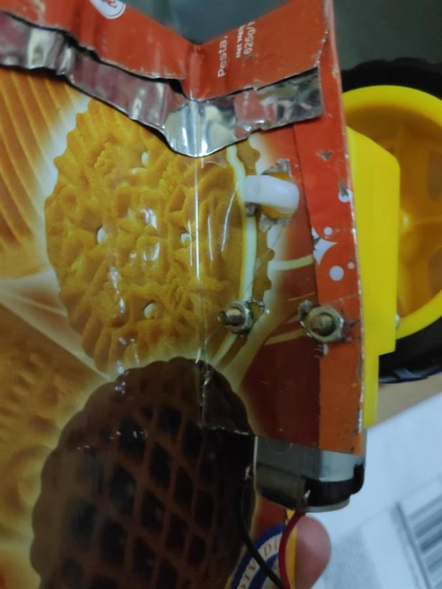

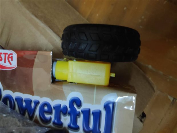

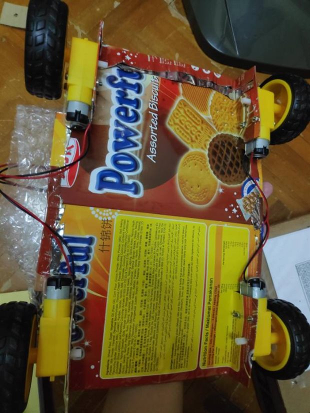

After some cutting and drilling, I have constructed the base of the Garbage Collector using biscuit tin and attached 4 DC motors to it:
Below is the video of base movement testing:

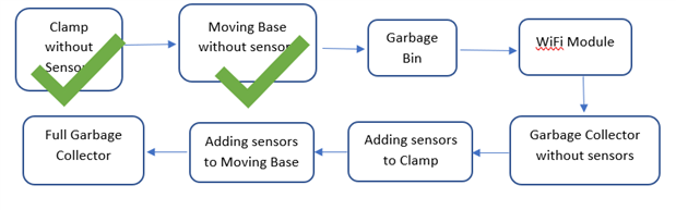

Design flow check point:
The next thing I will do is to change the controller to a wireless controller. Till then, see ya.
