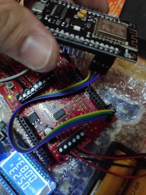

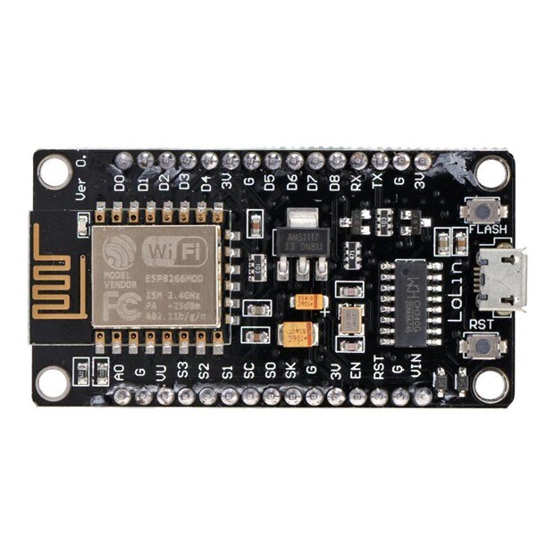

I have chosen to use NodeMCU to connect to the Wifi and at the same time communicate to the XMC4700 Relax Kit through GPIO.
By referring to the tutorial on Youtube https://www.youtube.com/watch?v=aw_3X-vp7aI&list=WL&index=48&t=0s&ab_channel=RoboShala , I was able to create an app to control the NodeMCU wirelessly, and eventually, the NodeMCU will communicate with XMC4700 using its GPIO.

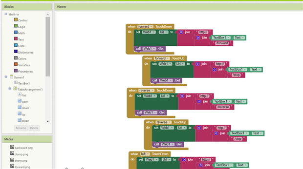

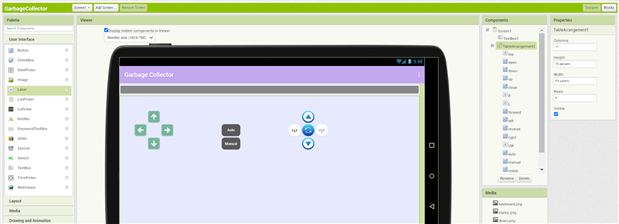

I have also created a mobile application using MIT App Inventor http://ai2.appinventor.mit.edu/ :
These are the files the project files and the application file of the mobile application:
GarbageCollector.aia:      https://drive.google.com/file/d/1Y7JBFpfzyy_74JlLXz_viGhGEDukXx5q/view?usp=sharing  (this is the project file to be imported into MIT App Inventor website in case you want to modify the mobile app)
GarbageCollector.apk:     https://drive.google.com/file/d/1BGUqz-hG-M4dnJ9xAlqZMnON4MUva2a-/view?usp=sharing  (this is the apk file to be installed to the mobile phone)
Controller.ino:                   https://drive.google.com/file/d/1csAxbVDEpEGvAw5EQfT8TB4ZNec8dwEG/view?usp=sharing  (Arduino project file to be uploaded to NodeMCU

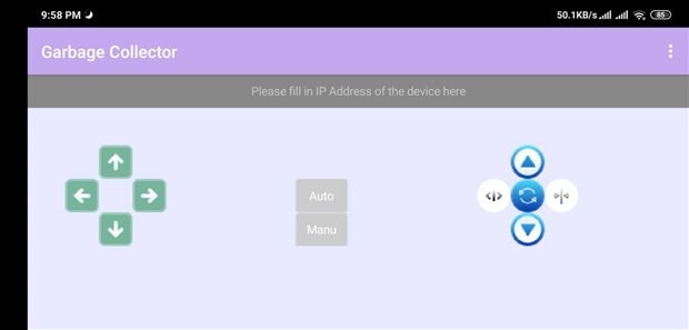

User Interface of the mobile application that I have created:
For the XMC4700 Relax Kit, the code that I'm using is the same code as in my previous blog post where the DAVE project can be cloned at the following GitHub link:
GitHub link          https://github.com/wanfp97/freertos_motor
I have connected pins D0, D1, D2, and D3 (representing forward, backward, left, and right) to the respective interrupt pins that I have set in the DAVE project for XMC4700 Relax Kit (P0.4, P0.1, P0.6, and P0.5).

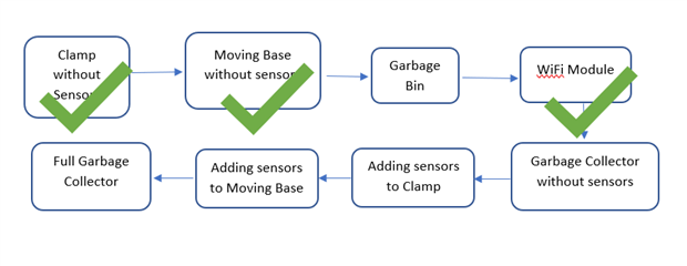

Design Flow:
What's Next?
I'm going to attach the clamp, garbage bin, as well as batteries to the base of the Garbage Collector and test them all at once. See you next blog.
