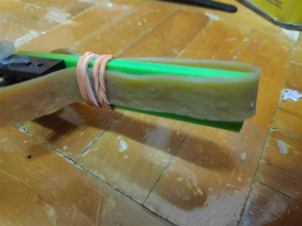

Clamp not strong issue workaround:
i) Adding rubbery surface as per suggested by the members of Element14 Community:

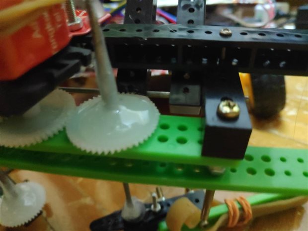

ii) Use hot glue gun to fix the shaft and the gear:

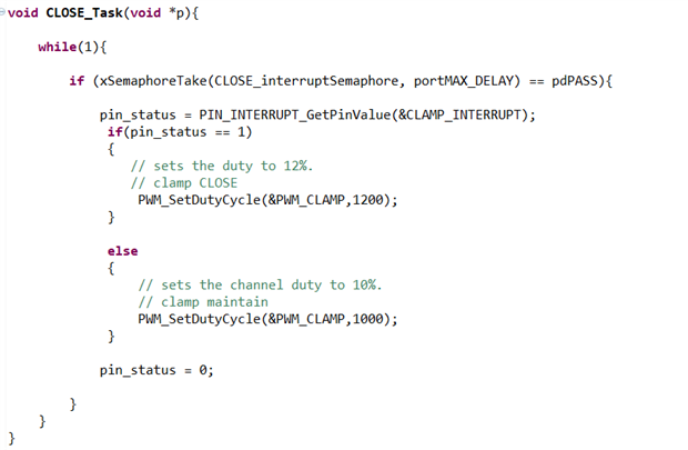

iii) Let clamp to continue applying a smaller force instead of completely stopping after successfully clamp the target:
Note that I'm using a 360-degree servo motor for clamping so the PWM duty cycle is to determine the direction and the force of the servo motor, unlike the normal 180-degree servo motor which uses the PWM duty cycle to determine the angle.
Here I programmed the servo motor to continue turning inward but with a smaller force after the button is released so that it will continue to apply force to hold the target.

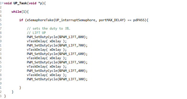

Servo motor jitter issue workaround:
i) Setting multiple waypoints with delays in between:
Note that this servo motor is a 270-degree servo motor that will use the PWM duty cycle to determine its angle.

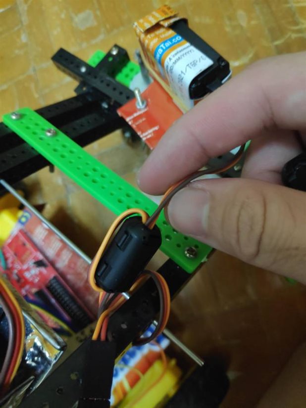

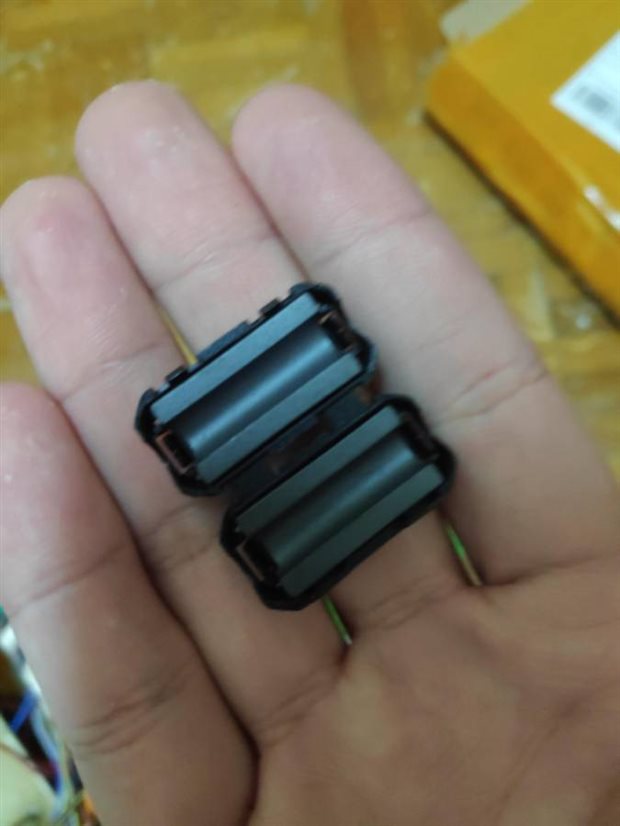

ii) Adding Ferrite core to the servo motor's wire.
I actually got this idea from the YouTube video below which demonstrates how adding a Ferrite core helps in solving the jitter issue:
adding the Ferrite core.

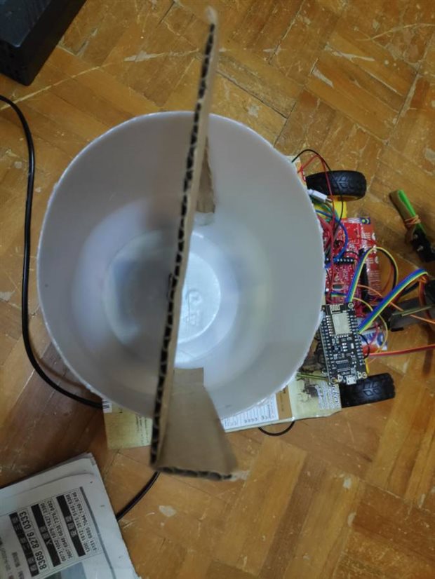

I have also added a compartment to the bin so that it can keep metals and non-metals item separately:
