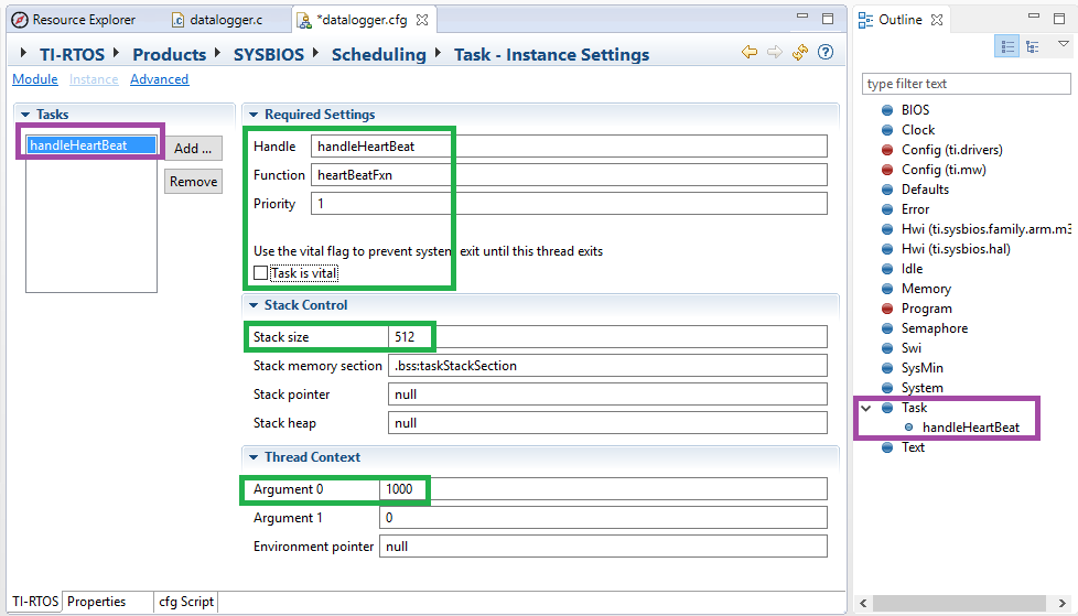

Configure the Blinky Task
The empty project registers the blinky task with code.
    /* Construct heartBeat Task  thread */
    Task_Params_init(&taskParams);
    taskParams.arg0 = 1000;
    taskParams.stackSize = TASKSTACKSIZE;
    taskParams.stack = &task0Stack;
    Task_construct(&task0Struct, (Task_FuncPtr)heartBeatFxn, &taskParams, NULL);
That's fine (you can also see the convention - used by many - to pass the scheduling time as arg0). You can use that method if you prefer.
In TI-RTOS, you can also set up the task with the configuration editor.
The result for your firmware is exactly the same, but you get some additional advantages:
  • all tasks and their priorities, stack size and timings available in one place
  • an editor to view and change task settings
  • a cleaner main()
Let's start by removing the program code that sets up our Blink task from datalogger.c. Just write down the settings that are used to create the task
Did that for you image : Stacksize 512, Sleep time 1000
Remove the following lines:
#define TASKSTACKSIZE   512
Task_Struct task0Struct;
Char task0Stack[TASKSTACKSIZE];
and:
    Task_Params taskParams;
and configure the scheduling again in the TI-RTOS configuration editor.
Double-click on datalogger.cfg. In the outline view on the right, select the Task node. Click Add....
A new form opens that lets you set the parameters:
Enter a name for the task handle. In the Function field, use the exact name of the blinky task (heartBeatFxn).
Priority is 1 (very low). The LED will give us a quick view into the RTOS scheduler health.
If the scheduler can't cope with the load, the rhythm of the LED will become irregular.
That's a great help during the development cycle.
Set the Stack size  and Argument0 value to those you've written down before.
Press the Save All button to apply the changes to both files we edited.
Build and execute again. The program behaves exactly the same as before.
That's what we wanted.
