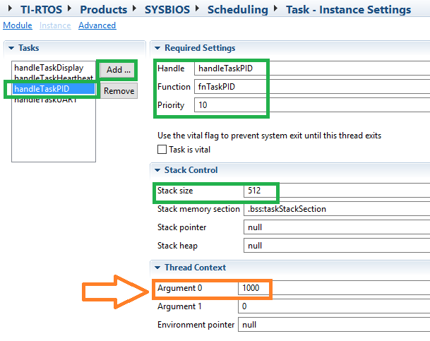

You can register the task in source code (as done in the TI-RTOS empty example) or by setting it up in the TI-RTOS configuration editor (check here for instructions).
Choose the sleep time based on the requirements of your control process. The 1000 ms that I've put here are arbitrary. You may want to adjust your process faster or less frequent.
If you use the task code above, the PID library's sample time will automatically be initialised to the timeout you define in Argument 0.
This line of code takes care of that:
pidSetSampleTime(((UInt)arg0) / Clock_tickPeriod);
Don't forget to register the TimestampProvider in the .cfg file, as explained above.
