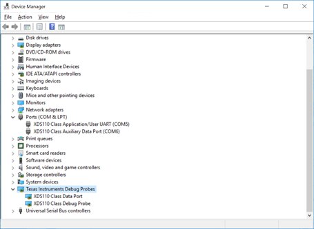

They say to finally connect your LaunchPad and it should automatically be recognized.
You can see the Ports and TI information for the XDS110 being recognized when the board is connected.
For some reason I had thought they meant the actual board would be recognized and I would see something like MSP423P401R.

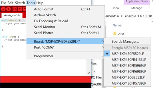

After extracting appropriately and running the energia program (I placed a shortcut to my projects area for easy access), you get the IDE.
As you can see though above there is no MSP432P401R option.  The guide says you just go to the board and choose the correct board.

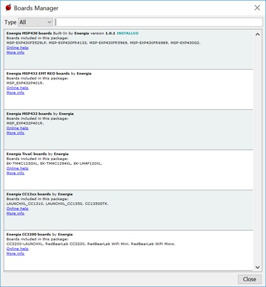

But! Back on the main page under notes for Energia 18 they let you know: “Default the Energia installation comes with support for the MSP430. Other cores such as TivaC, CC3200, MSP432 can be installed through the board manager by selection Tools->Board->Board Manager. “
So clicking on that Boards Manager option above the Energia MSP430 boards list gives you:
Here we have 2 potential choices:
Energia MSP432 EMT RED boards by Energia or
Energia MSP423 boards by Energia.  Both state that Boards included in this package:  MSP_EXP432P401R.

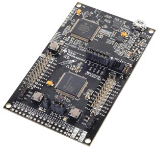

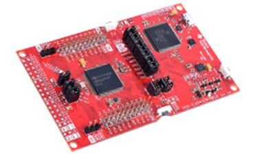

Looking at More info and Online help didn’t help me.  A little research and I found a pdf from Texas Instruments discussing the Black and the Red LaunchPad Development kits.
The Black kit is Revision 1 where as the Red kit is Revision 2.  Being as my board is very Red and all of the other videos I have seen out there were Black and the boards did look slight different...
Version 1.
Version 2.

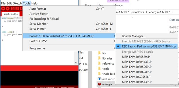

I choose the Red board option and clicked install.
Now I can see the RED LaunchPad w/msp432 available.

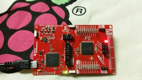

Generally one of the first things you try is to run the blinky LED sketch for testing. Above is a picture of my board before the IDE was setup and it is already continually blinking.  I am not sure if it is supposed to do that, in fact I assume it is not otherwise why have me run the blink sketch.  But a quick modification where I changed the blink time to 2000 and uploaded the sketch, then right away my blinks were 2 seconds lit, 1 second off.

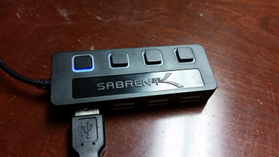

  1. 1.  I decided to add a 4 port powered USB switch instead of just pulling cords as needed.  This lets me just push a button.
I will probably just wire this into a test platform eventually.
Pretty simple but I like it better than my previous pull each USB cord as needed.

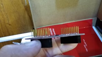

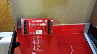

  1. 2.  Another box came in the mail!
Was a little surprised to see a pin bent at an odd angle, not sure how the bouncing inside of the box did that but those pins can be pretty “catchy.”
