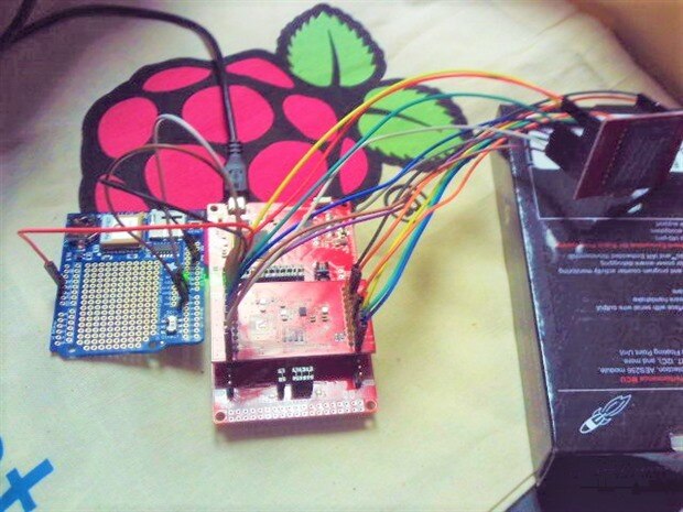

One of the big items I have been working has been just doing some basic testing to see how well the Ultimate GPS Data Logger shield would interface with the TI MCU and Energia.  Nothing too fancy, just trying to receive the basic NMEA string I was seeing with the Arduino UNO.
Sadly no success as of yet.  So I started working with some of the kit items to see if they interface well and that is showing progress.
Here I have the TI MCU (https://www.element14.com/community/view-product.jspa?fsku=2473128&nsku=41Y9541&COM=noscriptMSP-EXP432P401R ) with the Sensor booster ( https://www.element14.com/community/view-product.jspa?fsku=2510675&nsku=72Y1732&COM=noscriptBOOSTXL-SENSORS) mounted directly on top.  Off to the side I have the LCD booster (https://www.element14.com/community/view-product.jspa?fsku=2429519&nsku=11X5261&COM=noscript430BOOST-SHARP96), and of course on the left I have my Ultimate GPS Data Logger shield.
While my GPS is showing green and even eventually getting a full signal, at no time am I seeing anything coming across the Serial Monitor.  I will continue to pursue this and am wondering if some code I am working on that specifies GPS might be of assistance.
Actually having the kit in hand has let me lay out some of the boosters and I really like the idea of the sensor booster and the LCD booster applied to the CLEWE so these are the 2 boosters I am starting with while also trying to tie in the GPS.
As you can see with the picture I think I will be able to mount the GPS shield next to the Sensor booster and save some space.  The LCD will be slightly off so the project does not get to thick and unwieldy.  I still want to have space for the battery so the LCD will have a friend.

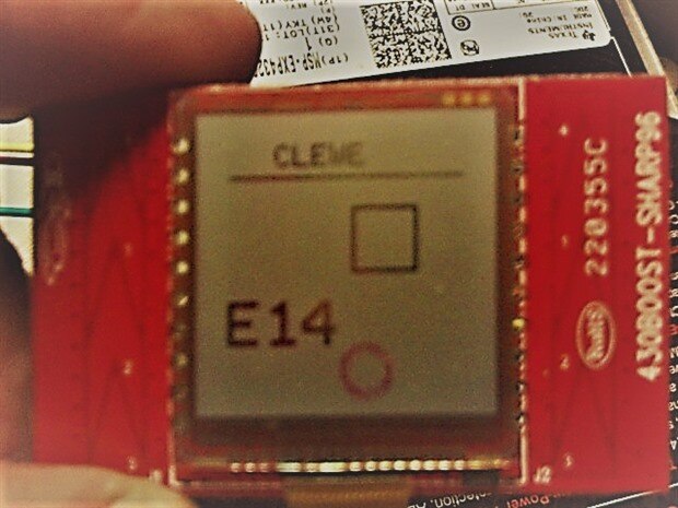

Off of the Energia website (appropriately found in the reference section,) I found some test code for the LCD_SharpBoosterPack.  It was based off of the 430 but is still valid and a quick and fun way to test the LCD.

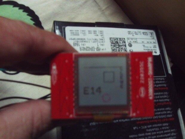

Just for fun I modified the two lines I highlighted in Green.  Replacing the "ABCDE" with "CLEWE" and the "ABC" with "E14"
If you are going to do a test you might as well make it fit your Project!
Here is a not so clear/sharp image of the LCD_SharpBooster Pack with CLEWE moving around.
