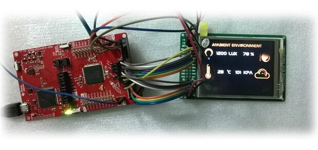

This blog is based on MSP432P401r and 320x240 pixel TFT display interface.
Objective:
According to my project proposal I have to design a wearable device mounted on the wrist of the Miners.
This wearable device consists of several sensors to collect environmental information.
The MSP432P401r MCU will collect the data from the sensors and display on the TFT.
In this blog post, I'll focus on
     - the interfacing of the TFT and the MSP432P401r MCU
     - display some dummy data to mimic the final system

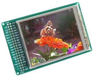

Display module:
I am using a TFT display for my project instead of the provided SHARP96 LCD, because I need a bigger display which is visible at low light.
This TFT display module has following features -image
     - 320x240 display resolution
     - ILI 9341 controller
     - 262.000 colours
     - Touch panel [not using for this project]
     - Back-light
     - 3.3V power supply voltage

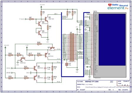

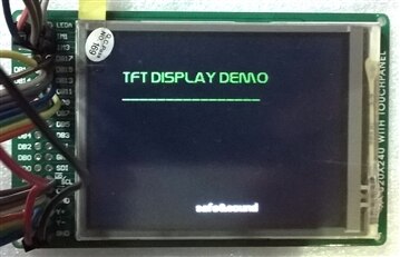

It is interfaced with the MSP432P401r MCU via 8-bit parallel connection.
IM[3:0]----------INTERFACE MODE----------USED PINS
__________________________________________
0011 -----------8-BIT INTERFACE -----------DB[17:10]

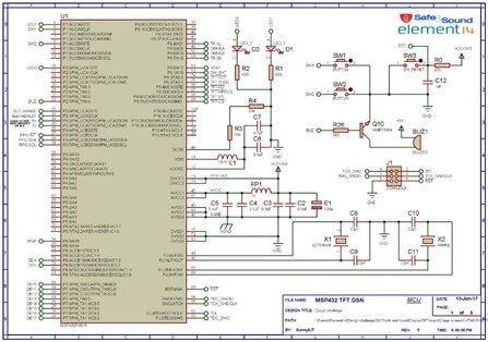

Interfacing:image
// TFT module connections
char TFT_DataPort at DIO_P7OUT;
sbit TFT_RST at DIO_P9OUT.B2;
sbit TFT_RS at DIO_P9OUT.B6;
sbit TFT_CS at DIO_P9OUT.B7;
sbit TFT_RD at DIO_P9OUT.B4;
sbit TFT_WR at DIO_P9OUT.B5;
sbit TFT_BLED at DIO_P9OUT.B3;
char TFT_DataPort_Direction at DIO_P7DIR;
sbit TFT_RST_Direction at DIO_P9DIR.B2;
sbit TFT_RS_Direction at DIO_P9DIR.B6;
sbit TFT_CS_Direction at DIO_P9DIR.B7;
sbit TFT_RD_Direction at DIO_P9DIR.B4;
sbit TFT_WR_Direction at DIO_P9DIR.B5;
sbit TFT_BLED_Direction at DIO_P9DIR.B3;
// End TFT module connections

CKT diagram:

void InitialDisplay() {
  TFT_Fill_Screen(CL_BLACK);
  TFT_Set_Font(Nasalization_Rg22x23_Regular, CL_GREEN, FO_HORIZONTAL);
  TFT_Write_Text("TFT display demo", 40, 40);
  TFT_Write_Text("________________", 40, 60);
  TFT_Set_Font(TFT_defaultFont, CL_WHITE, FO_HORIZONTAL);
  TFT_Write_Text("safe&sound", 135, 210);
  TFT_Set_Font(Nasalization_Rg22x23_Regular, CL_WHITE, FO_HORIZONTAL);

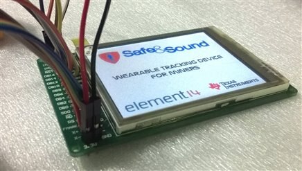

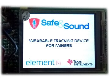

Safe&Sound cover screen:

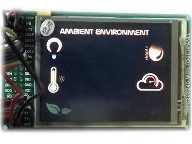

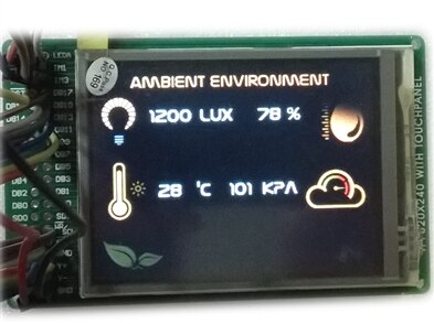

Environmental Info screen with dummy data:
void cover_screen() {
  TFT_Image_Jpeg(0, 0, cover_screen_jpg);
void screen1() {
  TFT_Image_Jpeg(0, 0, screen1_jpg);
void demo_data() {
  IntToStr (light, text_temp);
  TFT_Write_Text(text_temp, 55, 45);
  TFT_Write_Text("LUX", 120, 45);
  IntToStr (ambient_tmp, text_temp);
  TFT_Write_Text(text_temp, 55, 130);
  TFT_Write_Text("'C", 115, 130);
  IntToStr (humidity, text_temp);
  TFT_Write_Text(text_temp, 170, 45);
  TFT_Write_Text("%", 220, 45);
  IntToStr (pressure, text_temp);
  TFT_Write_Text(text_temp, 140, 130);
  TFT_Write_Text("KPA", 190, 130);
