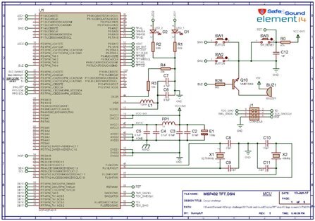

Full source code and circuit diagram can be found in LIBSTOCK.

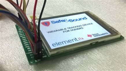

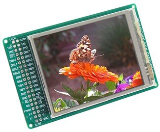

Display module:
I am using a TFT display for my project instead of the provided SHARP96 LCD, because I need a bigger display which is visible at low light.
This TFT display module has following features -image
     - 320x240 display resolution
     - ILI 9341 controller
     - 262.000 colours
     - Touch panel [not using for this project]
     - Back-light
     - 3.3V power supply voltage

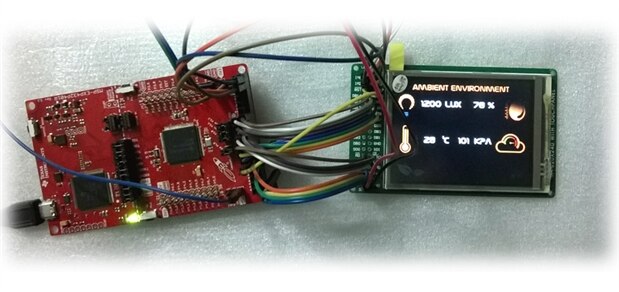

It is interfaced with the MSP432P401r MCU via 8-bit parallel connection.

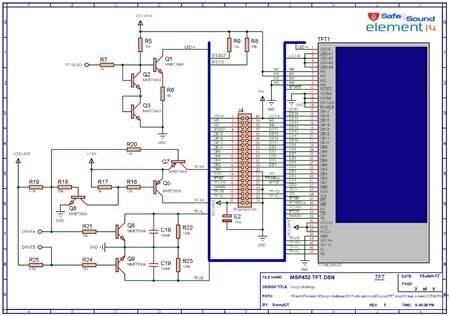

Interfacing:image
// TFT module connections
char TFT_DataPort at DIO_P7OUT;
sbit TFT_RST at DIO_P9OUT.B2;
sbit TFT_RS at DIO_P9OUT.B6;
sbit TFT_CS at DIO_P9OUT.B7;
sbit TFT_RD at DIO_P9OUT.B4;
sbit TFT_WR at DIO_P9OUT.B5;
sbit TFT_BLED at DIO_P9OUT.B3;
char TFT_DataPort_Direction at DIO_P7DIR;
sbit TFT_RST_Direction at DIO_P9DIR.B2;
sbit TFT_RS_Direction at DIO_P9DIR.B6;
sbit TFT_CS_Direction at DIO_P9DIR.B7;
sbit TFT_RD_Direction at DIO_P9DIR.B4;
sbit TFT_WR_Direction at DIO_P9DIR.B5;
sbit TFT_BLED_Direction at DIO_P9DIR.B3;
// End TFT module connections
dependencies -
  • TFT librabry
  • TFT_def library
resources -
// Resources
const code char Nasalization_Rg22x23_Regular[];
const code char Tahoma19x19_Bold[];
const code char Tahoma11x13_Regular[];
const code char cover_screen_jpg[61813];
const code char screen1_jpg[50682];
CKT diagram:

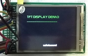

Display Initialization:
// Display Initialize
void DisplayInit() {
  //TFT_Init_ILI9341_8bit(320, 240);
  TFT_Init(320,240);
  TFT_BLED = 1;
  TFT_Fill_Screen(CL_BLACK);
  TFT_Set_Font(TFT_defaultFont, CL_WHITE, FO_HORIZONTAL);
  TFT_Set_Brush(1,CL_BLACK, 0, LEFT_TO_RIGHT, CL_BLACK, CL_BLACK );
void InitialDisplay() {
  TFT_Set_Font(Nasalization_Rg22x23_Regular, CL_GREEN, FO_HORIZONTAL);
  TFT_Write_Text("TFT display demo", 40, 40);
  TFT_Write_Text("________________", 40, 60);
  TFT_Write_Text("safe&sound", 135, 210);
  TFT_Set_Font(Nasalization_Rg22x23_Regular, CL_WHITE, FO_HORIZONTAL);

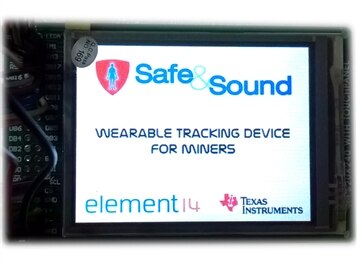

Safe&Sound cover screen:

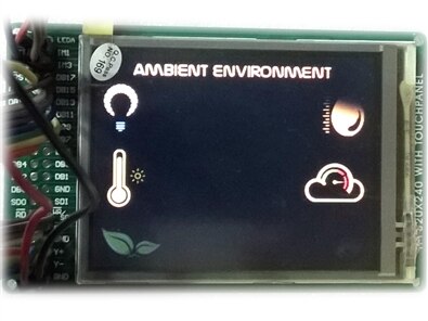

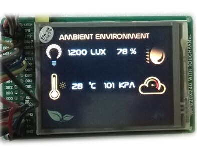

Environmental Info screen with dummy data:
void cover_screen() {
  TFT_Image_Jpeg(0, 0, cover_screen_jpg);
void screen1() {
  TFT_Image_Jpeg(0, 0, screen1_jpg);
void demo_data() {
  IntToStr (light, text_temp);
  TFT_Write_Text(text_temp, 55, 45);
  TFT_Write_Text("LUX", 120, 45);
  IntToStr (ambient_tmp, text_temp);
  TFT_Write_Text(text_temp, 55, 130);
  TFT_Write_Text("'C", 115, 130);
  IntToStr (humidity, text_temp);
  TFT_Write_Text(text_temp, 170, 45);
  TFT_Write_Text("%", 220, 45);
  IntToStr (pressure, text_temp);
  TFT_Write_Text(text_temp, 140, 130);
  TFT_Write_Text("KPA", 190, 130);
