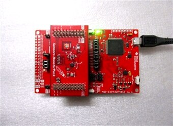

  • Sensors Boosterpack
  • MSP432 Launchpadimage

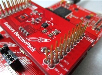

OPT3001 [BOOSTXL-SENSORS]:image
TI’s OPT3001 is an ambient light sensor. It’s a single-chip lux meter with infrared rejection. That measures only the visible
part of the light spectrum (mimicking the human eye’s response to light).
The sensor comes with BOSXL-SENSORS [sensors boosterpack] and  communicates with the MSP432 Launchpad using I2C.
     - operates at 3.3v
     - can produce hardware interrupt
OPT3001 I2C address = 0x47 (ADD pin is connected to SCL) [default in booasterpack]
OPT3001 I2C address = 0x44 (ADD pin is connected to GROUND)

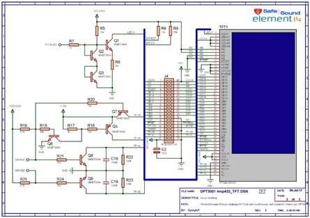

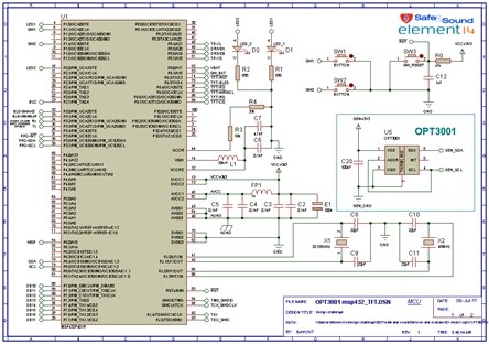

Circuit Diagram:
          MSP432P401r with OPT3001                                             TFT display connection

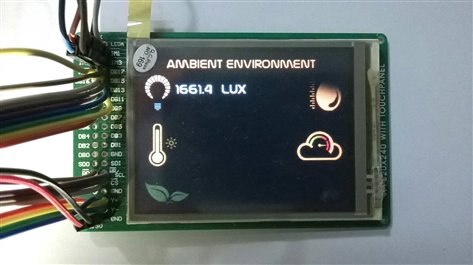

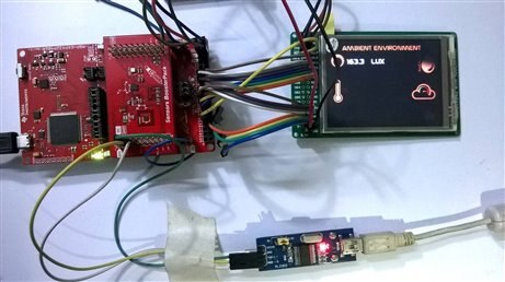

When tested in my room it gives a reading of about 163 LUX.
     Initialization screen               indoor ambient light intensity

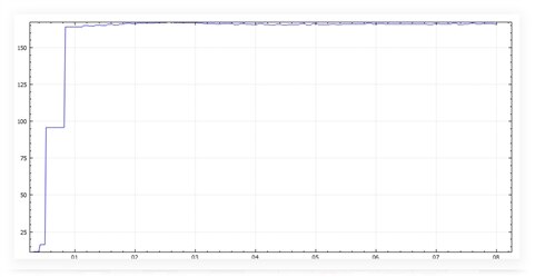

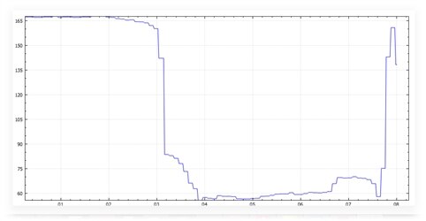

I have used "mikroplot" to graphically present the data over a time period. The MSP432 Launchpad communicates with the PC GUI through UART @ 57600 BAUD.
graph maintains ~163 LUX at indoor room light                            reading falls down to ~40 LUX with a transparent plastic placed on the sensor

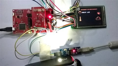

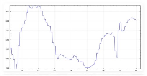

I have checked the response of the sensor with a smart phone flash light placed beside [horizontally] it. Reading goes up to ~2000 LUX.
variation of reading while moving the light source front and back -
