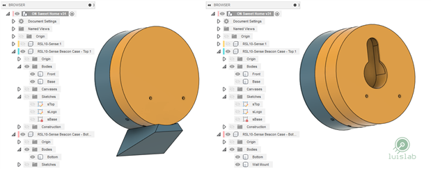

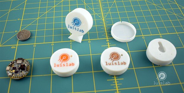

With the technical side of the project progressing well, I started 3-D printing some enclosures for the RSL10 Beacons -honestly I always find an excuse to add 3D printed parts to my projects. At this point I got creative and came up with various types of enclosures.
3D Print settings
Below the settings used in Cura:
  • Printer: Creality CR-10S
  • Material: PLA White
  • Infill: 20%, Gyroid
  • Adhesion: Skirt
  • Supports: No
  • Layer height: 0.2mm

There is not a lot to say here but let's mention some features that may not be noticeable:

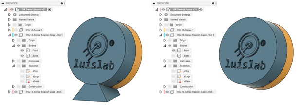

Front Cap
The front cap has tiny holes that allow the sensors inside to breathe and a place for a 2mm light pipe2mm light pipe. I designed two of them with/without 20 degree stand.
Back Cap
The back cap also has tiny holes that allow the sensors inside to breathe and a Wall Mount option
Now that the beacons have a place to be, the project is ready for the final wrap up.

    Very nice... How are you doing the color for the logo on the 3D prints?
  • luislabmo
    luislabmo over 6 years ago in reply to fmilburn +3
    Hello fmilburn and dubbie , Thank you for you comments. To make the colored logo this is what I regularly do: Design a recess in the 3D printed part of about 2-4 layer deep (use multiples of your layer…
    dubbie over 6 years ago in reply to fmilburn +2
    I definitely agree, Nice! And also, how did you do the coloured logos? I'm inspired to try doing this myself now - all I need is a Logo. Dubbie
