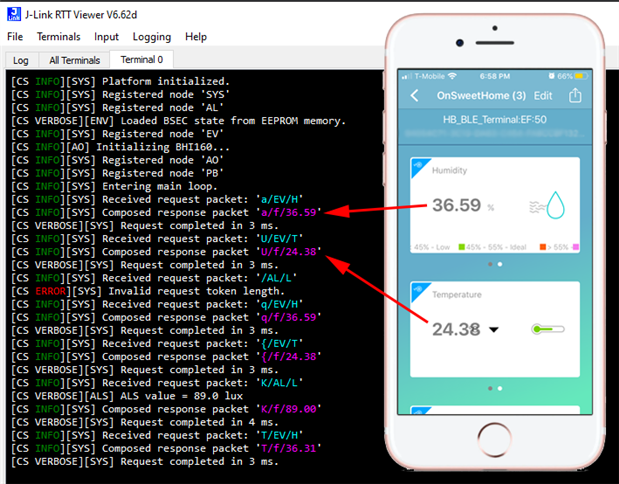

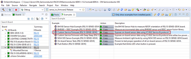

I started by using an existing example "Custom Service Firmware" available for RSL10-Sense devices in the On Semiconductor IDE which uses the ICS BLE Service Protocol to communicate (location highlighted in the screenshot below). To make things even better, the script can be used as is.
When running the example with the Debug Probe connected and the RSL10 Sense and Mobile app, the information is right there which gives us a clue as to how the information flows. It uses the GATT protocol which basically uses a Master_Request/Slave_Response approach.

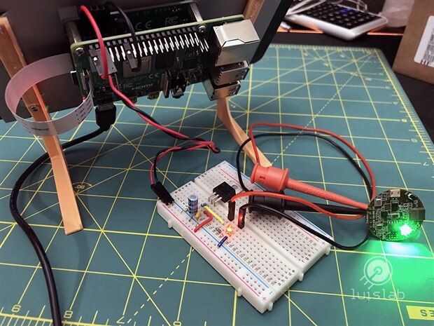

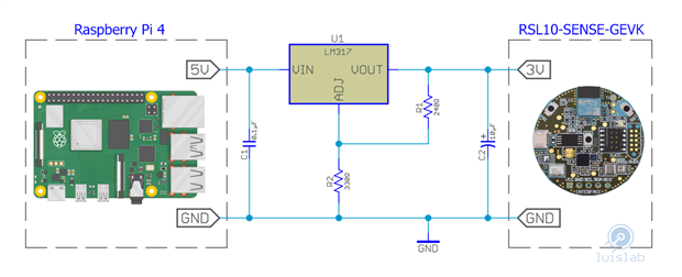

At this point of the project, a LM317 Adjustable Voltage Regulator comes in handy to power the RSL10-SENSE from the RPi during the tests and development. The LM317 outputs a voltage very close to 3V with  R1 = 240 Ohm and R2 = 330 Ohm

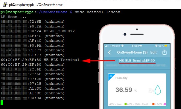

To start the testing, I used the following command which reveals all the BTLE devices around:
sudo hcitool lescan
Our RSL10 is right there in the list of devices

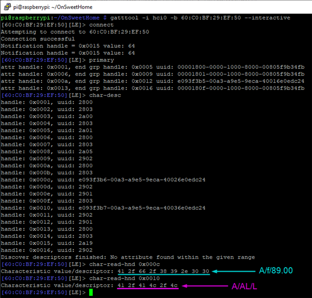

To look more in detail at the data structure of the BTLE device, I used the gatttool command, where I was able effectively see the last data from the device:

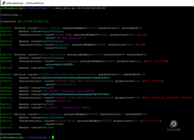

Considering that the tools I just presented reveal the data in raw format, this requires extra steps and/or external tools to convert between ASCII and HEX for a user to understand better. At this point, I decided to go with my own approach with a Python script that will display the same data in a friendly manner. It turned out better than I expected as it allowed me to understand better how the LE devices interact and it also worked as Debug tool very well.
As you can see, there is a lot of useful information in the picture above, like the Handles that describe the purpose of each Characteristic and the Battery Level (0x2A19) which I'm surprised is not being used by the RSL10 Sense and Control Mobile app.
Source code
The source code is available for anyone to use. It uses bluepy, a Python module that allows communication with Bluetooth Low Energy devices.
