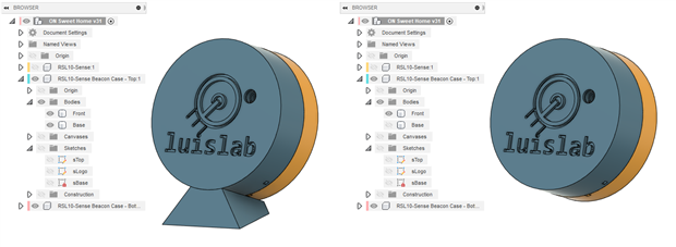

With the technical side of the project progressing well, I started 3-D printing some enclosures for the RSL10 Beacons -honestly I always find an excuse to add 3D printed parts to my projects. At this point I got creative and came up with various types of enclosures.
3D Print settings
Below the settings used in Cura:
  • Printer: Creality CR-10S
  • Material: PLA White
  • Infill: 20%, Gyroid
  • Adhesion: Skirt
  • Supports: No
  • Layer height: 0.2mm
Assembly
There is not a lot to say here but let's mention some features that may not be noticeable:
Front Cap
The front cap has tiny holes that allow the sensors inside to breathe and a place for a 2mm light pipe2mm light pipe. I designed two of them with/without 20 degree stand.

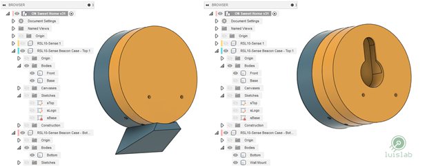

Back Cap
The back cap also has tiny holes that allow the sensors inside to breathe and a Wall Mount option

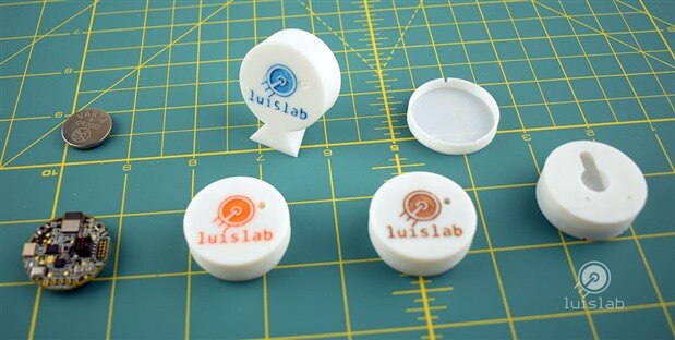

    fmilburn over 6 years ago +3
    Very nice... How are you doing the color for the logo on the 3D prints?
  • luislabmo
    luislabmo over 6 years ago in reply to fmilburn +3
    Hello fmilburn and dubbie , Thank you for you comments. To make the colored logo this is what I regularly do: Design a recess in the 3D printed part of about 2-4 layer deep (use multiples of your layer…
    dubbie over 6 years ago in reply to fmilburn +2
    I definitely agree, Nice! And also, how did you do the coloured logos? I'm inspired to try doing this myself now - all I need is a Logo. Dubbie
    Hello fmilburn and dubbie,
    • Design a recess in the 3D printed part of about 2-4 layer deep (use multiples of your layer height settings for better results). On big logos you can use more layers.
    • For big logos use a small syringe to fill in the recesses with some paint (I used water-based but there are better and more durable options)
    • For small logos I just use a very small detail-paint-brush and fill in the cracks with paint as best as I can.
      • For small logos, since is nearly impossible to add paint just in the recesses, I just sand with 1000-1500 grit until the paint imperfections aren't visible. It really helps here if you have a printer with a very smooth print bed -mine has a glass bed so parts come up near mirror finish (not a lot of sanding needed in this case)
    • (optional) add a translucent protective paint coat.
    Here is how a Tennis Racket Butt cap looks like (this one is the first colored logo I made)
    Hope this helps.
    Luis
