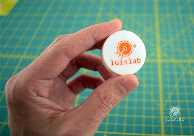

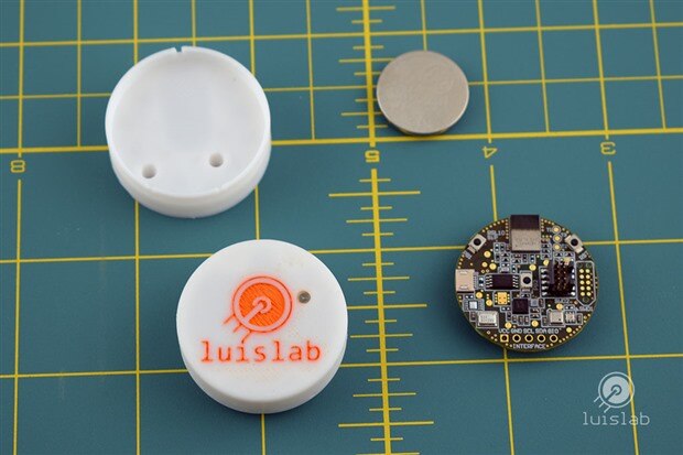

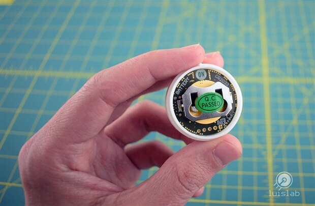

I'm really excited to show the completed project to my fellow readers. For the wrap-up post I made a GUI with Python and Tkinter to collect and display all the beacons data. In the video, two beacons are connected providing Temperature, Humidity and Battery Level feedback regularly.
The Python program that reads all the sensor's data uses the functionality which I developed and explained in a previous blog post.

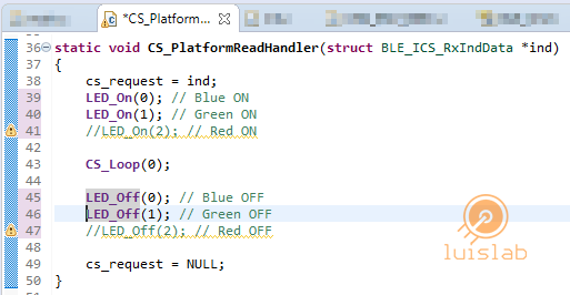

To capture the events in the video, I modified the RSL10 firmware (file CS_Platform_RSL10_HB.c) in order to turn ON the built-in RGB LED while the communication is in progress (Request and Response) which can be appreciated in few parts of the video.
static void CS_PlatformReadHandler(struct BLE_ICS_RxIndData *ind)
    cs_request = ind;
    LED_On(0); // Blue ON
    LED_On(1); // Green ON
    //LED_On(2); // Red ON
    CS_Loop(0);
    LED_Off(0); // Blue OFF
    LED_Off(1); // Green OFF
    //LED_Off(2); // Red OFF
    cs_request = NULL;

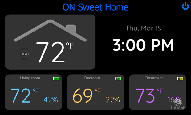

GUI Features
The GUI is designed to display the current date and time which are constantly being updated. It has a working power button which closes the application and room for 3 widgets (one beacon each) with some level of customization.
For each widget, the Beacon name or is displayed at the top, temperature, humidity and Battery Level are displayed and refreshed regularly. The Battery Level is displayed as a progress bar which changes color from green (good), yellow (medium) and red (low battery).
When tapping the Temperature Scale ºF or ºC it will automatically convert the temperature between Fahrenheit and Celsius (seen also in the video).
Source Code
The GUI can be launched remotely and will provide text feedback on the events that are happening in real time. To launch the GUI on the Pi's main screen, run the following before running the Python script remotely:

    if tempScale == 'C':
      tempC = int((self.beacons[i][1] - 32) / 1.8)
      self.beacons[i][3].set(str(tempC))                 # Temperature C
    else:
      self.beacons[i][3].set(str(self.beacons[i][1]))                 # Temperature F
    self.beacons[i][4].set("°" + tempScale)                # Temperature Scale (C, F)
    self.beacons[i][6].set(str(humidity) + "%")           # Humidity
    self.beacons[i][8].place(x=posX+240-35+(20-canvW), y=posY+13)   # Battery level bar
    self.beacons[i][8].config(bg=canvBG, width=canvW)
  def changeTempScale(self, i):
    if self.beacons[i][2] == 'F':
      self.beacons[i][2] = 'C'
    else:
      self.beacons[i][2] = 'F'
    print("Changed temperature scale to °%s, Widget[%d]" % (self.beacons[i][2], i))
    self.refreshWidget(i)
  def addWidget(self, mac, name, color, posX, posY):
    canvW=20
    widgName = tk.Label(self, text=name, font=("Arial 12"), fg="gray60", bg=self.widg_bg)
    widgName.place(x=posX+105, y=posY+15, anchor="center")
    batteryIcon = tk.Label(self, image=self.iconBattery, fg=self.widg_bg, bg=self.widg_bg)
    batteryIcon.place(x=posX+240-40, y=posY+10)
    canvBatt = tk.Canvas(self, width=canvW, height=10, bg=self.gui_bg, highlightthickness=0)
    tempStr = tk.StringVar()  # Temperature
    tempScl = tk.StringVar()  # Temperature Scale
    humdStr = tk.StringVar()  # Humidity
    # Initialization Values
    self.beacons.append([None, \
                         0, \
                         "F", \
                         tempStr, \
                         tempScl, \
                         35, \
                         humdStr, \
                         0, \
                         canvBatt, \
                         [posX, posY]])
    self.beaconsLen += 1
    i = self.beaconsLen - 1
    if mac:                             # Add BTLE beacon (RSL10-SENSE-GEVK)
      self.beacons[i][0] = beacon(mac)
      self.getBeaconData(i)
    else:                               # If no beacon available, make random data available
      self.beacons[i][1] = random.randrange(68, 74)
      self.beacons[i][5] = random.randrange(10, 25)
      self.beacons[i][7] = random.random()
    widgHumidity = tk.Button(self, textvariable=self.beacons[i][6], font=("Quicksand", 24), fg=color, bg=self.widg_bg, \
                             activebackground=self.widg_bg, highlightthickness=0, bd=0, command = None)
    widgHumidity.place(x=posX+150, y=posY+130, anchor="sw")
    widgTemp = tk.Button(self, textvariable=self.beacons[i][3], font=("Quicksand", 62), fg=color, bg=self.widg_bg, \
    widgTemp.place(x=posX+123, y=posY+30, anchor="ne")
    widgTempScale = tk.Button(self, textvariable=self.beacons[i][4], font=("Quicksand", 21), fg=color, bg=self.widg_bg, \
                              activeforeground=color, activebackground=self.widg_bg, highlightthickness=0, bd=0, height=1, width=1, command=lambda: self.changeTempScale(i))
    widgTempScale.place(x=posX+110, y=posY+47, anchor="nw")
  def refresh(self):
    self.refreshDateTime()
    if self.refreshLoop >= 2:
      self.getBeaconData(0)
      self.getBeaconData(1)
      self.getBeaconData(2)
      self.refreshLoop = 0
    else:
      self.refreshLoop += 1
    self.refreshWidget(2)
    self.after(5000, self.refresh)
cl = console_log(True, True)
app = Application(800, 480)
app.addWidget(mac='60:C0:BF:29:EF:50', name='Living room', color="#66ccff", posX=20, posY=310)
app.addWidget(mac=None, name='Bedroom', color="#ff9900", posX=280, posY=310)
app.addWidget(mac=None, name='Bedroom', color="#cc66ff", posX=540, posY=310)
app.after(0, app.refresh)
app.mainloop()
print("Bye.")
{gallery:width=648,height=432,autoplay=false} ON Sweet Home
Enclosure: Enclosure with wall mount for the RSL10-Sense-Gevk
Enclosure: Enclosure Top Cap (RSL10-Sense-Gevk)
Enclosure: Enclosure Top Cap - Rear (RSL10-Sense-Gevk)
