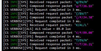

Before we start, it is important to understand how the Requests (cyan) and Responses (purple) are structured - example below:
Custom Service Request
Using the feedback from the Debug Probe and and with some digging at the RSL10 example firmware, we can see that the command requested (cyan color) is segmented in 3 parts; separated by the '/' (slash ASCII character) .

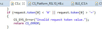

Token
What seems to be a random ASCII character between '0' and '~' (0x30 to 0x7E)

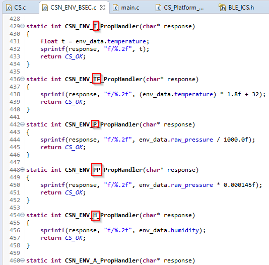

Node
Name of the sensor that will provide the data. e.g.: AL (Ambient Light) PB (Push Button), EV (Environmental - Temp, Humidity, Pressure, Air Quality)
Handler
Defines the property or in other words, what kind of measurement is requested to the sensor.
e.g. For the "EV" (Environmental Sensor) these are some of the options
  • T: Temperature in Celcius
  • TF: Temperature in Fahrenheit
  • H: Humidity
Custom Service Response
Once more, we will take a look at the debug probe feedback (purple color) to see how the response packet "generally" looks:
Token
The RSL10 device will respond with the same token that was sent in the request; an ASCII character between '0' and '~' (0x30 to 0x7E)
Data Type
When returning numbers, the RSL10 will respond with the following:
  • f: when the value of the sensor is a float (or contains decimals)
  • i: for integer values
Sensor Value
And finally the value of the sensor

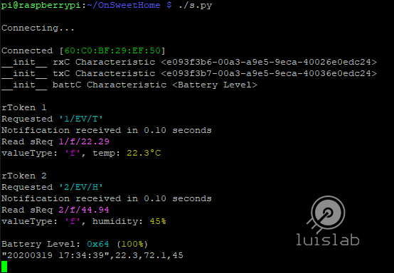

Below is what the output looks like

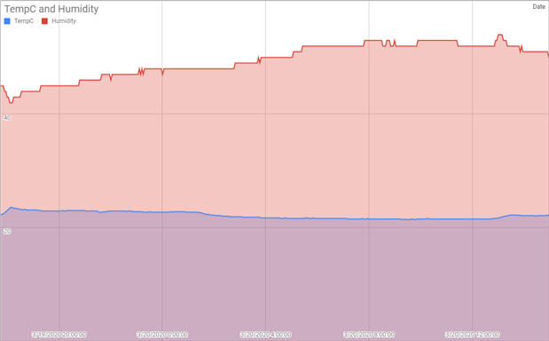

The data collected is also stored in a .CSV (example attached)
