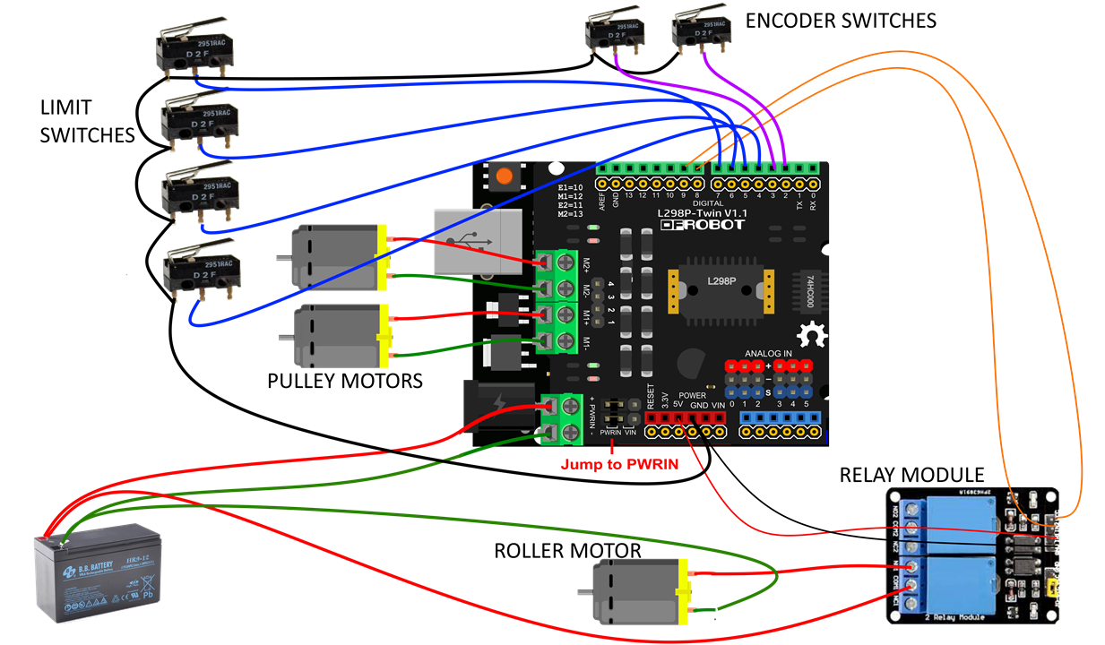

1. Connections overview
Picture below shows the components and the wiring
Main components are
  • Arduino Uno R3 board
  • Gravity: 2 x 2A Motor shield for Arduino to control the motors that move Rullit around
  • 2 relay module to control the solenoid valve (to dispense water and detergent) and the roller motor
  • 4 limit switches (front, rear, left and right) to stop Rullit when the edge of the PV modules has been reached
  • [Experimental] 2 limit switches to implement a rough encoder and detect the real length of thread winded or unwinded. This could be useful because, at low PWM values, motors may stall and this may add an error that accumulates over time. The first release of the robot will not include this feature. I will evaluate performances and decide whether to implement it or not

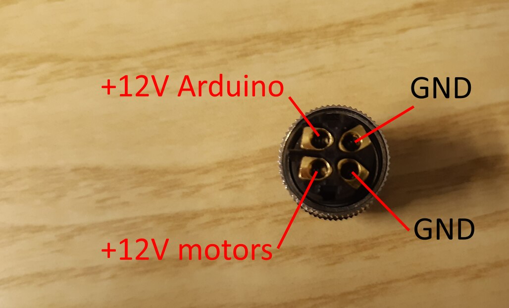

2.1 Connector N. 1: Power supply
The metal M8 connector will connect the battery to the Arduino board.
SKU: 71AJ9362
Manufacture part#: T4011019041-000
Description: Sensor Connector M8, Male 4 positions, Cable mount
SKU: 71AJ9360
Manufacture part#: T4010019041-000
Description: Sensor Connector M8, Female 4 positions, Cable mount
This connector has four pins and screw terminals – the wrench to tighten the screws is included
Looking at the power section of the Arduino Uno R3 board, it looks like it can not handle all the Amps the DFRobot motor shield can handle. The DFRobot shield is rated for a maximum current 2 x 2A, but the schematic of the power section of the Arduino board shows that a diode is mounted to prevent damages due to inverted polarity
I can't read the actual code of diode on the Arduino board, but a typical diode can handle a maximum current of about 1 A. For this reason, I will use two separates 12V power supplies: one for the Arduino board (through the jack connector) and one for the DFRobot shield (through the two wire screw terminals)

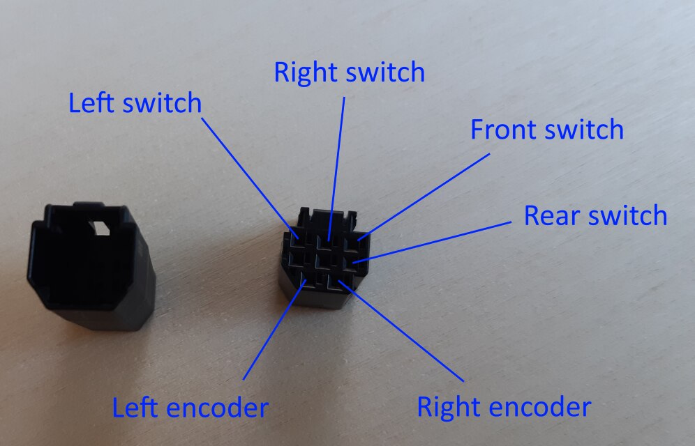

2.3 Connector N. 3: Inputs
The third connector brings input signals from encoder and limit switches.
SKU: 53AJ9500
Manufacture part#: 1-2366515-8
Description: DYNAMIC D1000 SLIM WIRE-TO-WIRE CONNECTOR receptacle : 8 positions, 2 mm pitch key 1
SKU: 53AJ9503
Manufacture part#: 1-2366600-8
Description: DYNAMIC D1000 SLIM WIRE-TO-WIRE CONNECTOR pin housing : 8 positions, 2 mm pitch key 1
Here is the pinout of the connector
NOTE: because the kit includes only 10 contact pins and housings, I will re-use the ground signal available on connector N.2
