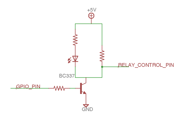

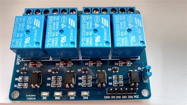

I am going to use an eight port version of the relay module posted right below. I have the module, but it is wired up currently for testing as I have just finished testing my circuit I am going to build to control this set of relays.
Now with these Opto-isolated relay modules, the pins need to be floating or tied to 5V to be off and connected to ground to be in a on state.  For this I have wired up a simple inverter circuit that helps me with another problem with the mini and that is 1.8V.
This is one of eight I will use to control the 8 relays on the board for the 8 outlets.  The LEDs will go the front of the unit it display power status to each outlet. I plan on making this control board to plug into the relay circuit to keep the wire count to a minimal.

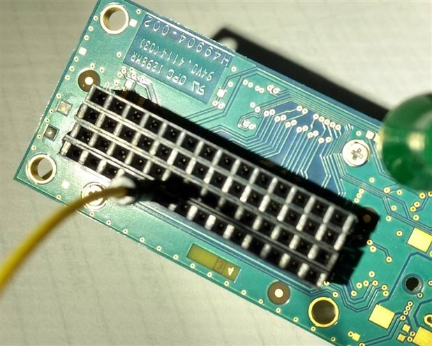

Edison Mini-board
I have added a header to the bottom of the Mini-board and that will plug into another board for power and GPIO. That other board will be mounted inside the PDU, so that the Edison is easily removed if need be.

    jasonwier92 over 9 years ago in reply to Workshopshed +2
    Thank you! I have seen partial headers and I have seen male headers, but I wanted female so the pins do not get bent on the part I do not want to solder often.
