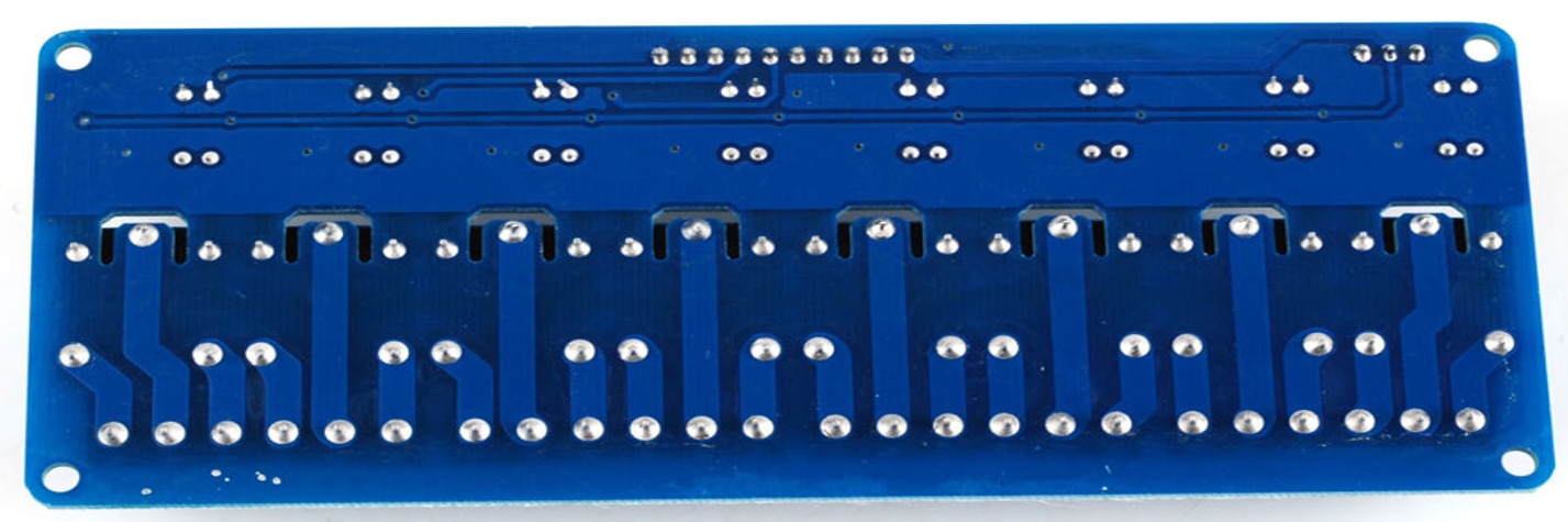

Outlet Switching
I am going to use an eight port version of the relay module posted right below. I have the module, but it is wired up currently for testing as I have just finished testing my circuit I am going to build to control this set of relays.

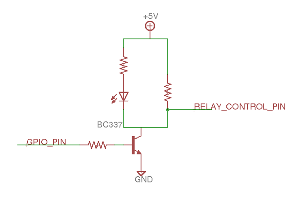

Now with these Opto-isolated relay modules, the pins need to be floating or tied to 5V to be off and connected to ground to be in a on state.  For this I have wired up a simple inverter circuit that helps me with another problem with the mini and that is 1.8V.
This is one of eight I will use to control the 8 relays on the board for the 8 outlets.  The LEDs will go the front of the unit it display power status to each outlet. I plan on making this control board to plug into the relay circuit to keep the wire count to a minimal.

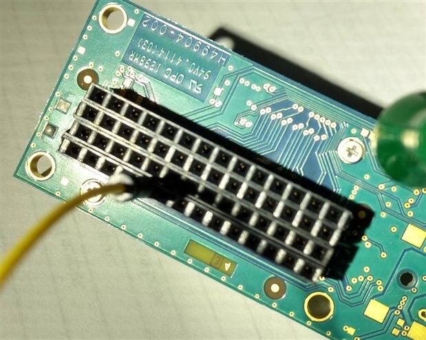

Edison Mini-board
I have added a header to the bottom of the Mini-board and that will plug into another board for power and GPIO. That other board will be mounted inside the PDU, so that the Edison is easily removed if need be.

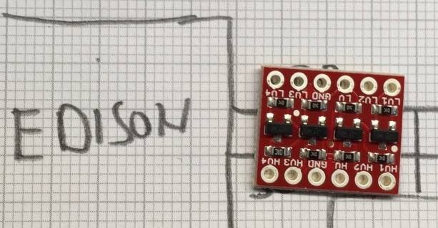

Only other thing I need to control is the LCD that will be mounted in the PDU. I will use the Adafruit 4-Bit Level Converter for to bring the I2C 1.8V to 5V fro the LCD.

    The header on the bottom of the mini-board is a brilliant idea!

    I'm using a Sparkfun level converter, Looks like its circuit is the same as the Adafruit, featuring the BSS138 FETs. Only the color of the board is different. In my case the Sparkfun works like a charm…

    Thank you! I have seen partial headers and I have seen male headers, but I wanted female so the pins do not get bent on the part I do not want to solder often.
    Only the color of the board is different. In my case the Sparkfun works like a charm image.

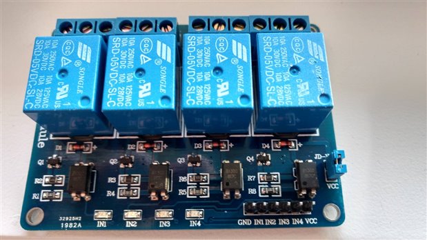

    mcb1 over 9 years ago in reply to jasonwier92
    My relay module look just like that one.

    I'd strongly suggest you add a piece of wire (solid is fine) to increase the current carrying capability.
    You can detail that this is required and just show one to demonstrate the process ....
    Basically any of the parts should be capable of carrying whatever the input power allows ... something along the cliché of the weakest link...

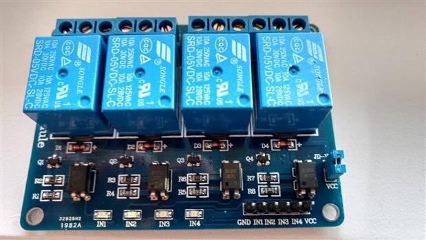

    I like the header idea.
    The relay board has the option of removing the jumper and adding 1.8v.
    You would need to bypass the onboard LED and reduce the resistor, but it might work.
    Perhaps I need to try it ....image
    It wouldn't give you the LED for the front panel, so your transistor interface is a good compromise.
    BE AWARE
    While the relays are rated at 10A, often the pcb is NOT.
    You may wish to solder a heavy solid wire to reinforce the current carrying capabilities of the track.
    Hopefully your unit has the slot around the common terminal of the contacts as this one does.
    For this project, everything is inside the unit, but the normal mains safety advice applies to ensure that you don't end up with a mains voltage where it shouldn't be.
