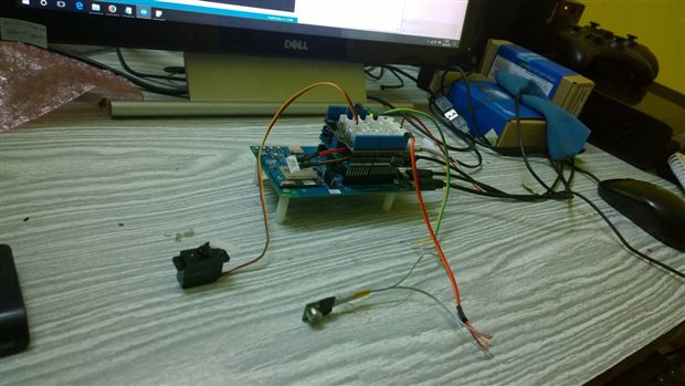

I wanted to re-purpose the Omron D6T, I2C MEMS IR sensor to track movement and direction. The one I'm using here is Omron D6T-8L, with 8 pixels.
How its works:
The sensor has a resolution of 1x8, what I've done is read all the 8 pixel values and find the largest of it and the  corresponding pixel and map the value to a Servo.
The Setup:
Connections
Omron D6T     EDISON
SCL        -->        SCL
SDA        -->        SDA
5V           -->         5V
GND        -->        GND
Servo                     Edison
Signal      -->     Any PWM pin
5V            -->             5V
GND        -->            GND
The Code :

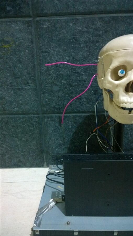

Lets Track...

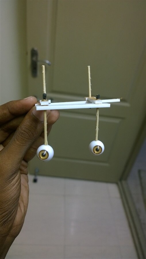

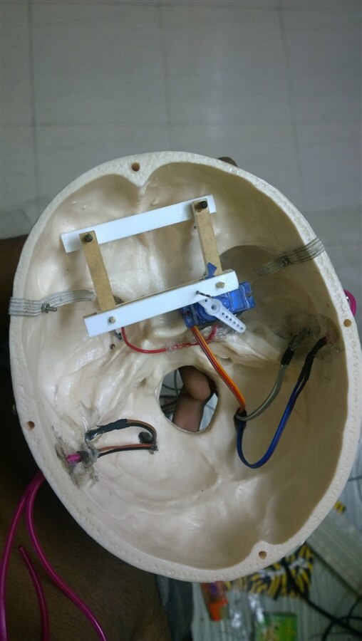

I made a simple mechanism to make the eyes move, i thought of 3d printing them but old acrylic pieces and a few match sticks came handy. also mounted with the skull.
You guys will be meeting Funeka mostly my 28th image Here's some sneak peek
