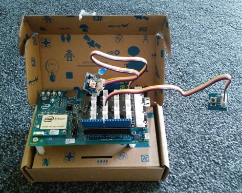

As mentioned previously my daughter helped me assemble the Edison and Arduino breakout board.

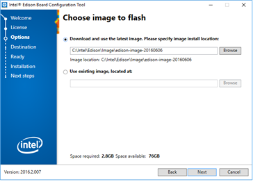

Installation

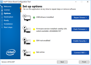

I followed the Getting Started with the Edison guide for Win32. The drivers download page suggested that the drivers were only for 64bit Windows but installed just fine, as did the FTDI drivers. However when I ran the setup the Intel Edison Setup application it seemed to remove those drivers and replace with some others. Once the new drivers were installed I picked the option to download and install the latest firmware.
We named the board "Eddie", enabled SSH and connected up to the Wifi. Once the board finished and rebooted I checked I could ping
Eddie.Local
I also checked we could connect with SSH and login as root, using Putty. Once in I double checked the version.

Quick test with MRAA
I mashed together a few articles to get myself a blinking LED on D7 on the grove shield
#!/usr/bin/env node
var mraa = require('mraa');
console.log('MRAA Version: ' + mraa.getVersion());
var led = new mraa.Gpio(7);
led.dir(mraa.DIR_OUT);
var ledState = true;
setInterval(function () {
 led.write(ledState?1:0);
 ledState = !ledState;
}, 1000);
