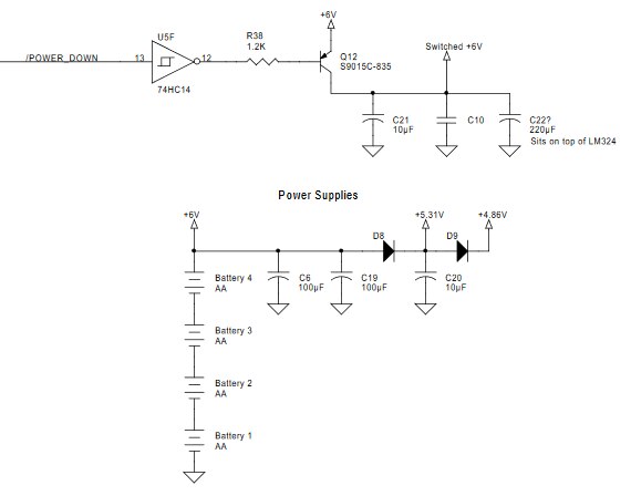

The Furby has a surprisingly sophisticated power setup. It has raw 6v from the batteries, 5.13v used by the main processor, 4.86v used by the EEPROM and a switched 6v used by the audio and IR sensors.
One thing that is missing from the schematic is what powers the 74HC14 which is used for the driving the LED and processing the opto-sensor signal. I checked and it was connect to the 6v line.

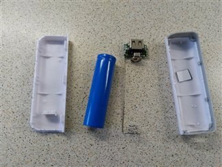

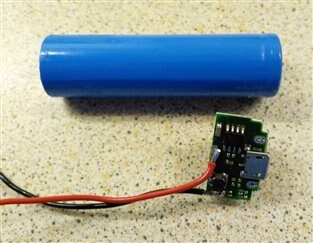

I've broken down a second powerbank into it's constituent components. It's interesting to see that there is just a single MP3401A chip and a few discrete components.
