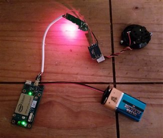

The volume from the headphones was not very loud so amplification was necessary. Interestingly, the Furby does not have an audio amplifier although that may be tucked away in the COB#2. So I used a new PAM8302A 2.5W amplifier module.
I wired the amplifier supply to the power lines on the USB, IN- to GND, IN+ to one of the audio channels and /SD to +5v. And tested.
USB On the Go

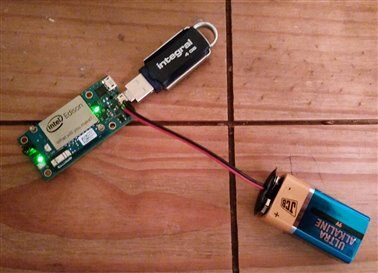

The Edison mini has micro USB sockets and my sound card had a full sized USB. I could have included an adapter but instead I decided to put on a micro-USB connector with the suitable OTG wiring i.e. pins 4 and 5 shorted, so that it would correctly be detected by the Edison.
Here's the connections seen from the plug end.
It was at this point I realised I still had an issue powering the Mini-Breakout board. Because of the extra regulator on the J21 route it won't run from the 5v I was producing from my battery box. It would run fine from the USB (at 5v) but I now needed that for the sound card.
The Grove kit came to my rescue in that it had a PP3 to Jack connector. I cropped that off and connected on a 2 pin socket.
I plugged it all together and my audio did not work. I had a little adapter that turns big USB into mini so I used that with a memory stick to check that the port was working. It was, so I returned my audio card to the bench and resoldered the connections. I hooked it back up and this time it was properly detected. So I tested it one last time with the audio file, "I'm feeling better now, I really am".
