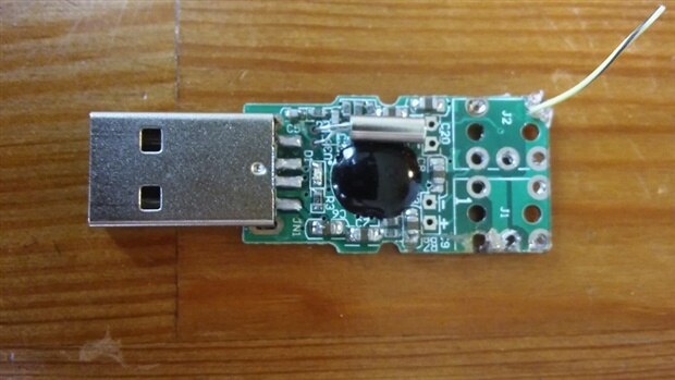

I tested the dongle with my netbook under WIN10 home, still no sound.
I checked the connection from settings, no problem. The mixer would auto swap from netbook's speakers to USB dongle, but no sound.
I opened the dongle, tested the jacks and then removed them, soldering directly wires to make sure I had eliminated possible connection problems, but again nothing. I decided to recycle it.

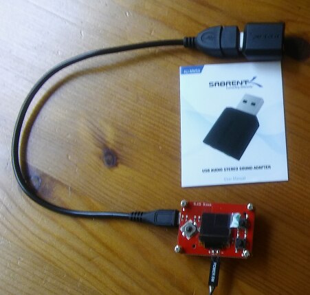

I ordered a pair of new USB Audio cards (for backup purposes) and upon arriving yesterday, I tested them. Success. They both worked fine out of the box. And yes, this time I could hear the sound on earphones and my amp.
The dongle is Sabrent USB Audio Stereo Sound Adapter, specified to work with Win, Linux and Mac OS. Cost was really low at $ ~6.
My testing started the opposite way this time, first on my netbook and then on the Edison.
In both instances it was recognized. Under Win10, it installed some driver from the web.
On the Edison, I simply issued the command
aplay -D default:Device mytest.wav
and there was sound.
