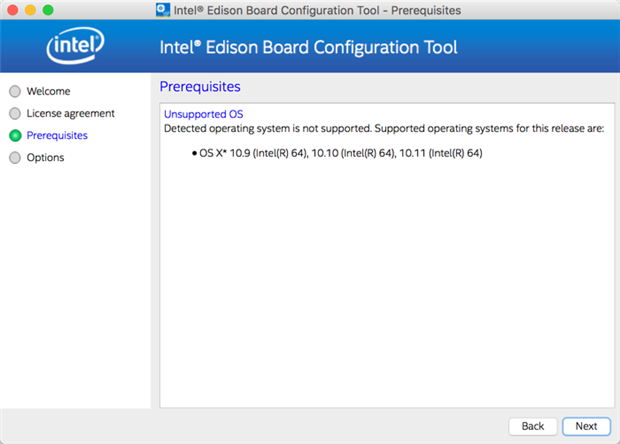

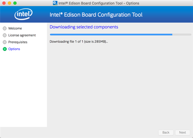

Then I connected the usb cables and downloaded and started the setup tool.

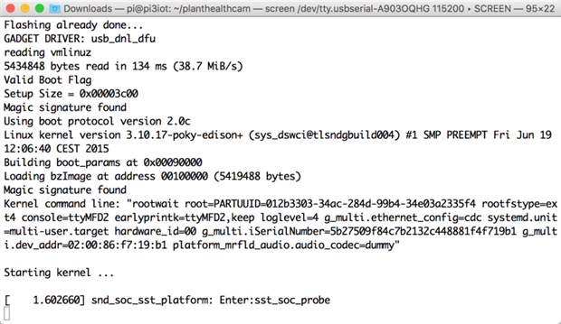

To my surprise I got an error, stating that my macOS version wasn't supported. I ignored the message and could install everything almost without any problem. As jasonwier92 already mentioned (The Kit and Exploring Edison OS's [Upcycle It #2]) you can monitor what's happening by connecting a terminal to the bottom micro usb port. On macOS the terminal command is the same as on Linux:
     screen /dev/tty.usbserial-A903OQHG 115200

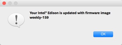

First I Flashed the Firmware:
After pressing the button the firmware was downloaded an flashed into the system:
It took some time to download 285Mb.
On the console monitor you can follow the progress:
Finally I got the message that the firmware was properly installed.

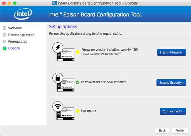

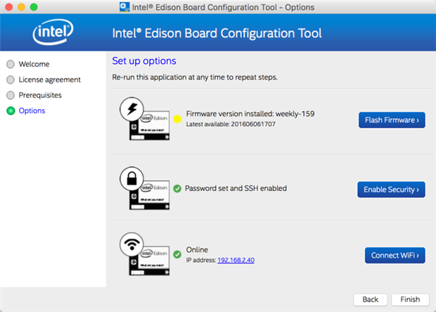

Unfortunately for some reason the sign is still yellow, indicating that there might be an even newer version.
I still have to investigate this.

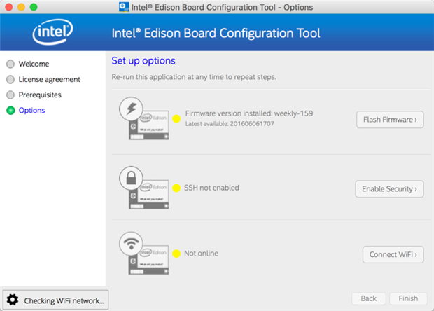

After setting a pasword the next sign went green.
And the same for the WiFi connection.

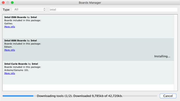

Arduino
For the SDK I decided to start with Arduino.  The Arduino SDK was already on my PC, I'v lot of Arduino compatible boards around. I didn't install a new instance and rename it to ArduinoEdison as proposed by Intel, but just added the Edison using Arduino's board manager.

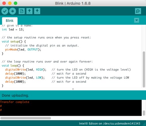

The ultimate Arduino 'Hello World' program is of course the blinking LED.
I opened it from the menu, compiled and loaded it to the Edison, where the LED immediately started blinking.
So first test passed image
