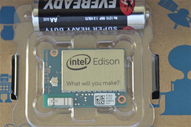

When it arrived, it was astounding how small it was.
This is the module compared to an AA battery
Photo three minions  me, myself and I
It certainly fitted the small size that it claimed.
Unfortunately as I dug into it, I realised that the module on it's own was well ..... power less.
So this tiny board needed to be connected to something else in order to power it, let alone get to the GPIO.

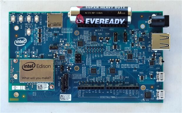

I did order the Arduino Kit to go with the module, and this solves all the access issues, but adds some extra real estate.
In case you've lost the module, it's in the bottom left corner

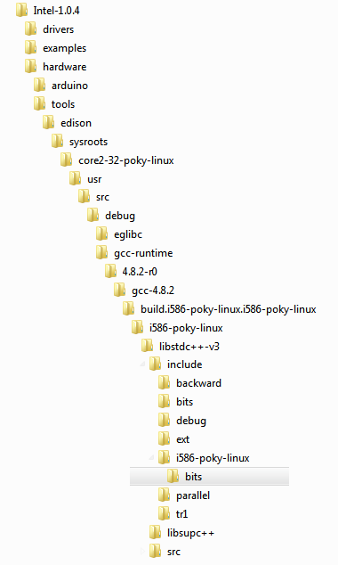

The extraction had issues with 17 files.
          Cannot create arduino-1.5.3-Intel.1.0.4\hardware\tools\edison\sysroots\core2-32-poky-linux\usr\src\debug\gcc-runtime\4.8.2-r0\gcc-4.8.2\build.i586-poky-linux.i586-poky-linux\i586-poky-linux\libstdc++-v3\include\i586-poky-linux\bits\messages_members.h
              Total path and file name length must not exceed 260 characters
Once I added my directory onto it, the full name went to 283 characters. (23 more than the maximum in Win7)
Since my path length was 23 to start with and a further 23 were added by the extraction process, the 46 characters had to be reduced .... somehow.
It meant comprimising where I put the files, or changing how I extracted the files.
To give you an idea this is the tree (I've omitted some directories)
As you can see it is rather long and quite frankly .... a bit unplanned.

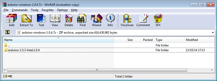

The other option is to open it with another utility.
I have an Evaluation copy of WinRAR which open a .7z file as a directory structure.
The default option is to just select the file and then "Extract To".

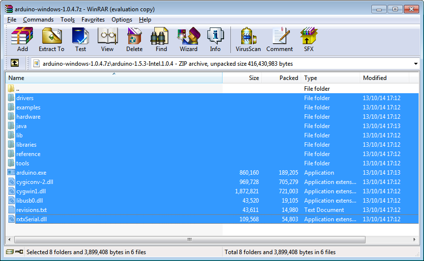

BUT if you click on the folder it will display all the underlying folders.
Select all
and then "Extract To" and choose your location and folder name.
The leading directory name will be removed.

    I'm quite impressed with this little board especially when you consider that most of that area isbasically a breakout board for the teeny little module in the corner!!!

    Onboard flash.
    The SD card is on the Arduino expansion board, and is not part of the OS or boot process.
    They are a great little device, but sadly they do need a 'base' board to provide power at the minimum.
    Personally I'd have added a 5v reg and two pins even if it made it a little larger.
