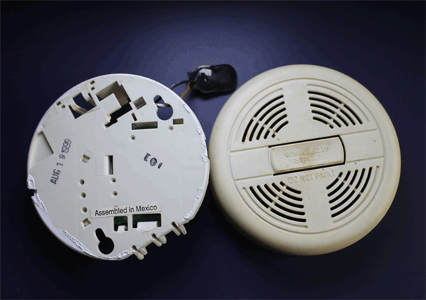

This is my first post as part of Upcycle It design challenge.
Project idea:
I have an old smoke detector that I would like to use in combination with other wifi connected electric appliances (I haven't seen yet a "smart oven" in BestBuy), which has a risk of causing fire or other devices that can control electricity supply to them (as suggested by mcb1 - like Sonoff WiFI switch or the project by jasonwier92) I want to add a wireless connection to the smoke detector, so when it detects smoke (or other properties of fire like higher then usual temperature) from a connected appliance, it can send an alert to a smart phone, as well notify the IoT connected smart appliance, so it can automatically turn off itself. Hopefully this project will make my home a safer place with the reuse of old electrical equipment and Intel Edison Arduino Kit.

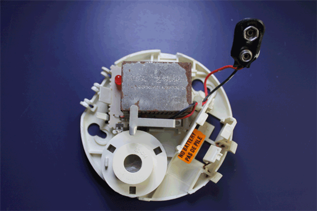

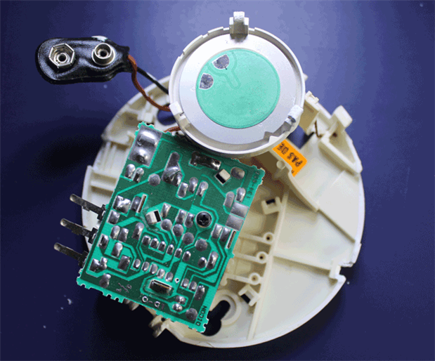

While I'm waiting for Intel Edison I inspected at my old smoke detector. It is quite old (produced in 1999). It still can produce noise during push test. But I will run a real "smoke test" to see if its sensor can still detect smoke. (Update: The smoke test confirmed that it is still working as expected). Just in case it is not working I've ordered a new smoke sensor MQ-2 as Grove-Starter Kit doesn't have one. It is Arduino compatible and quite inexpensive. (Update: It will be interesting to compare precision of MQ-2 vs. built-in sensor. But I expect that built-in sensor is consuming much less energy.).
It requires 9V power supply.
And this is back side of its board and buzzer.
