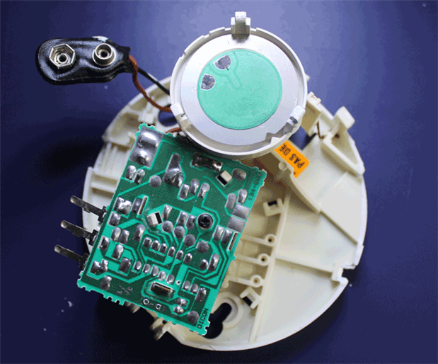

While I'm waiting for Intel Edison I inspected at my old smoke detector. It is quite old (produced in 1999). It still can produce noise during push test. But I will run a real "smoke test" to see if its sensor can still detect smoke. (Update: The smoke test confirmed that it is still working as expected). Just in case it is not working I've ordered a new smoke sensor MQ-2 as Grove-Starter Kit doesn't have one. It is Arduino compatible and quite inexpensive. (Update: It will be interesting to compare precision of MQ-2 vs. built-in sensor. But I expect that built-in sensor is consuming much less energy.).
It requires 9V power supply.
And this is back side of its board and buzzer.

    The smoke test confirmed that my old smoke detector still working as expected.

    mcb1 over 9 years ago
    I was recently informed that smoke detectors over about 10yrs can still make noises under test, but don't detect smoke.
    The NZ Fire Service promotes smokes alarms and changing the battery every change in Daylight saving, but I've never heard them suggest replacing them periodically.
    There are a range out here that include a 10yr warranty and a 10yr battery, and the cost is less than the alternative plus 3 batteries.
    So if you have older detectors fitted (why you wouldn't is beyond me), it's probably worth checking, it's the one time your friend that smokes will be welcome indoors. image
