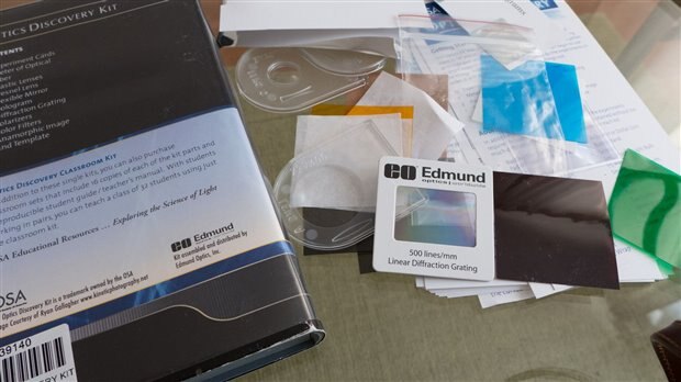

    Anyway, your post reminded me of this childrens' optics kit that costs just $18 from Edmund Optics:
    It really is very basic (a few plastic lenses, some filter sheets, a plastic mirror etc) but does come with a thin plastic sheet of diffraction grating (500 lines/mm) mounted in a card frame.
    That could be used for a more consistent, repeatable design I guess. It behaves similar to the half DVD, i.e. it is transmission, not a reflective.
    It is a shame the kit doesn't have any slit.
