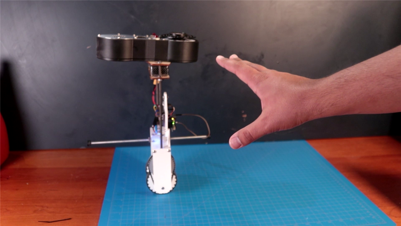

Adam takes on the challenge of using a PID (Proportional Integral Derivative) controller in a robotics project. He is interested in robotics and has experience with Halloween animatronics, but PID control presents a new level of complexity. PID is commonly used in advanced robotics projects. Examples include balancing robots or systems that require precise control to stay centered, such as a platform with a bouncing ping-pong ball.

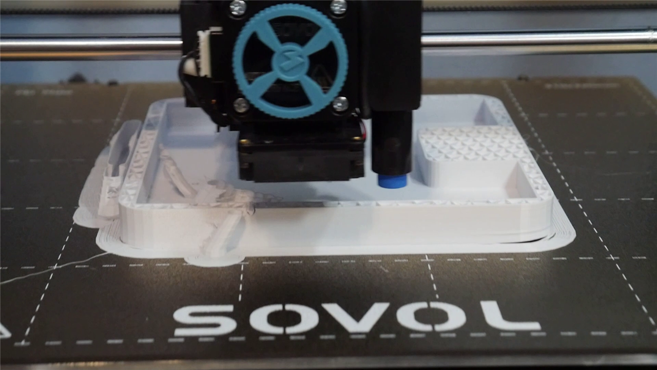

To realize his design, Adam has iterated through various prototypes and 3D-printed parts for the robot. He used M3 screws for all components to avoid the need for hot glue or modifications. The robot features two large tires, and Adam plans to add electrical tape for better traction on hardwood surfaces. Despite the challenges during the design phase, he is excited about the potential success of the final product.
3D Print

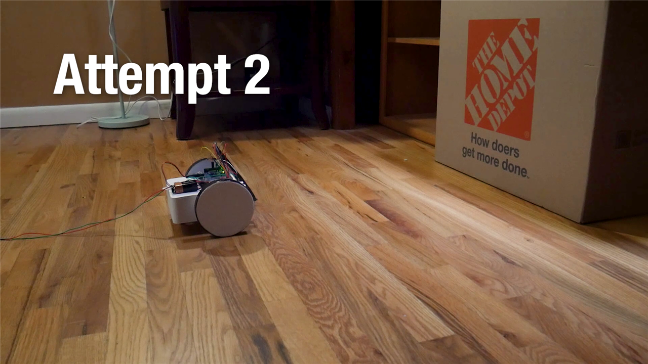

During the PID tuning process, Adam faces some difficulties. He turns to a chatbot for code assistance, but the provided code has some inaccuracies for his specific setup. Regardless, the code from the chatbot gives him valuable insights and prompts him to think about setting PWM limits and stopping when the target distance is reached. This process highlights the complexities involved in fine-tuning PID controllers for individual systems.
Attempt 2
After adjusting his code and robot setup, Adam sees significant improvements in performance. Although there are still some issues with overcompensation and occasional tipping, the robot is now much closer to achieving its desired behaviour. PID tuning is an art form, it requires patience and understanding of numerous factors beyond just the constant values.

    Vehicle dynamics and tuning PID loops can get very involved as you are demonstrating. The distance output from an ultrasonic sensor is slow, which creates a long feedback cycle so there is not much feedback to work with in the time frame you need it. The motor response needs to be slowed down enough to give the feedback time to take effect. If you turn the proportional gain way down, it shouldn't respond so violently to feedback. If there is residual error, increase integral gain. Derivative gain can improve response time but is pretty dangerous, since it can easily make a system unstable.
    You may need to run the motors very slowly for this sensor and system to be easier to tune and work smoothly with PID.
