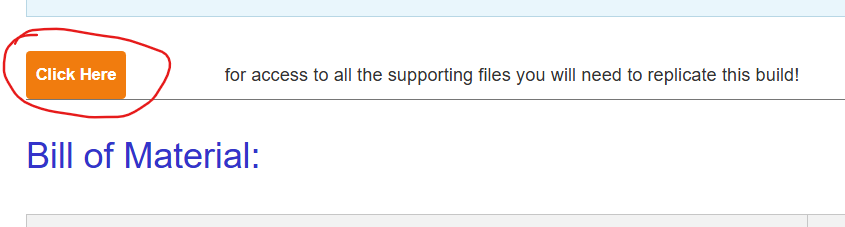

Click Here for access to all the supporting files you will need to replicate this build!

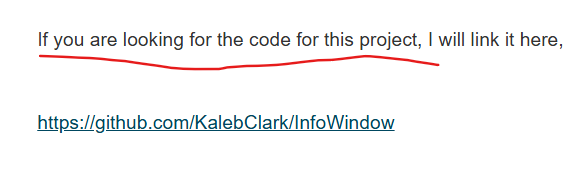

    beacon_dave over 1 year ago in reply to anthony26ca
    https://github.com/KalebClark/InfoWindow/tree/master
  • anthony26ca
    anthony26ca over 1 year ago
    Where can I find the code to do this project? I have all the parts.
