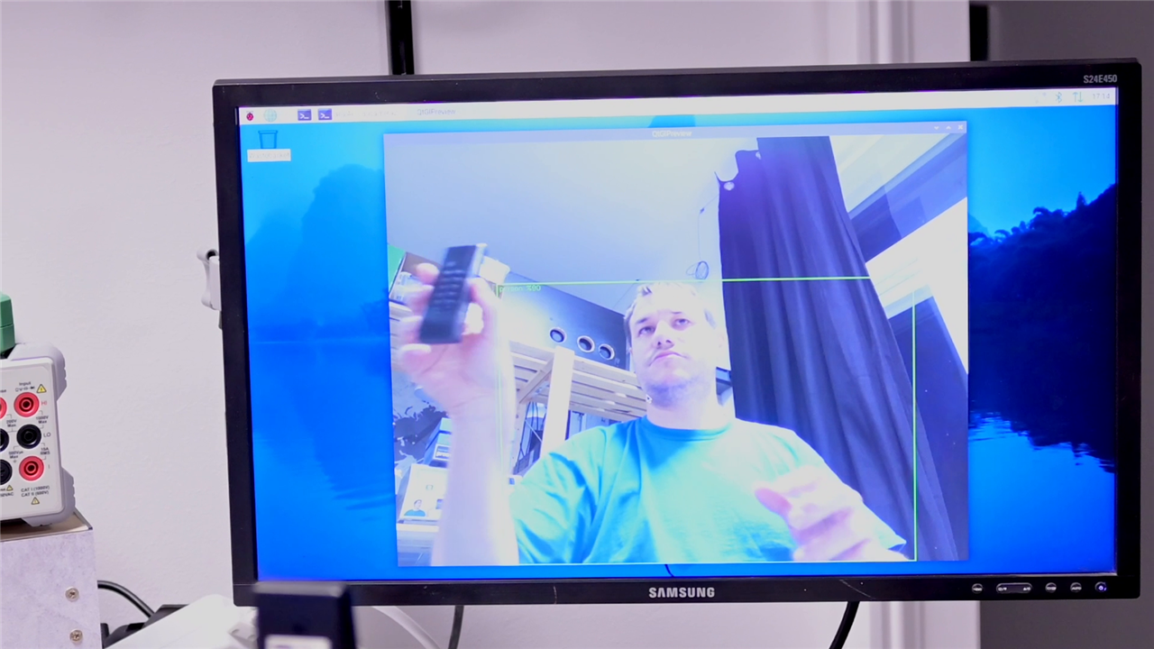

With vision as the focus, the skull’s behaviour becomes far more intentional than in the original build. Instead of reacting to every detection, the system selects a single “object of interest” and commits to it. Humans are prioritised, but devices such as laptops and keyboards are also recognised and tracked when relevant.
Clem describes the selection criteria as simple but effective: the system focuses on the object it is most confident about—the closest, largest, and clearest detection in view. Once chosen, the skull moves to keep that object centred in the frame, using pan and tilt servos to follow it smoothly.
Just as important is knowing when not to move. The skull allows for a generous margin where the object can drift within the frame without triggering motion. This reduces constant jitter and gives the movement a more deliberate, lifelike quality. If nothing is detected, the skull recentres itself and waits. If something suddenly enters from the edge of the frame, it snaps to attention—an effect Clem admits can be genuinely startling when you forget the system is running.

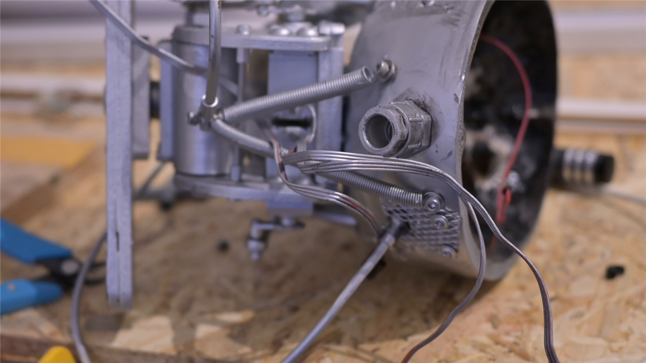

No amount of AI can fully mask the physical realities of a handmade animatronic mechanism. Clem is candid about the skull’s construction: it is intentionally compliant, meaning it will give way if touched. This makes it safe, there’s no risk of pinched fingers, but it also introduces unavoidable jerkiness into the motion.
Rather than fight this in software, the system adapts to it. Movement smoothing, dead zones, and proportional control help reduce unnecessary corrections, but the AI ultimately learns to tolerate mechanical imperfection. The result is not polished in a cinematic sense, but it feels responsive and believable, arguably more so because of its flaws.

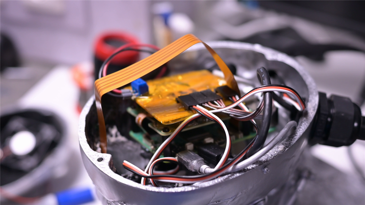

Clem managed to fit all processing hardware inside the skull itself; the only external component is the power supply in the base. Two hardware switches allow the system and motors to be powered independently, making it easy to shut everything down if the skull starts doing something it shouldn’t.
The servo control hardware was assembled by hand using breadboards and prototyping board, with modified headers to ensure reliable connections. It’s not elegant, but it’s practical, and emblematic of the project as a whole.
