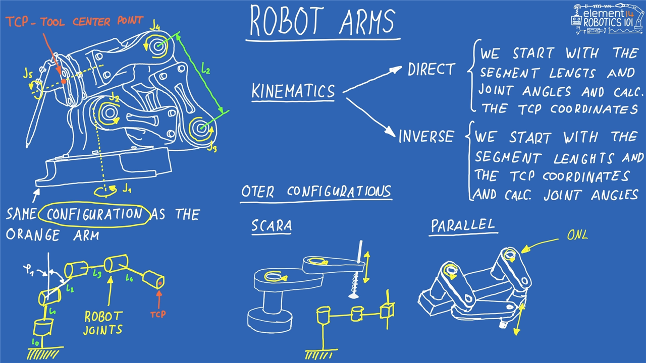

Understanding Robot Arms and Kinematics
Before touching any hardware, Milos begins with one of the most important concepts in robotics: robot arm configuration. Whether a robot is a compact desktop arm, an industrial manipulator or a SCARA system, every robot arm can be described by its joints, the links connecting those joints and the position of its tool centre point (TCP).
Once the joint positions and link lengths are known, it becomes possible to describe the entire robot mathematically. This is where kinematics enters the picture.
As Milos explains:
“When we talk about robot arms, we're usually interested in kinematics. That means direct kinematics and inverse kinematics.”
Direct kinematics starts with known joint angles and link lengths and calculates the position of the TCP. Inverse kinematics takes the opposite approach. A target position is specified first, and the required joint angles are calculated afterwards.
“Maybe we want to place the tool at a certain coordinate. To do that we need to calculate all of the angles in the joints.”

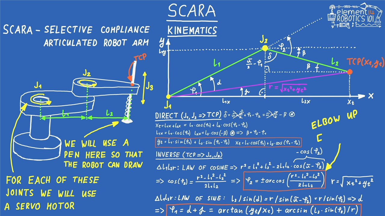

The robot built in this project uses a SCARA (Selective Compliance Articulated Robot Arm) configuration. Unlike a traditional articulated robot arm with many joints, a SCARA robot uses two rotary joints operating in a plane and a simple actuator for vertical movement.
This simplified structure makes it ideal for learning robotics because the mathematics remains approachable while still introducing the same principles used on larger industrial systems.
Milos also highlights an important concept encountered in real robotic systems: multiple inverse kinematics solutions.
“We can reach the same point with two distinct configurations.”
These are commonly referred to as elbow-up and elbow-down configurations. Both reach the same TCP coordinate while positioning the robot differently.
The project also introduces singularities. In the fully extended position, the robot loses one of its available configurations and can only reach that point in a single orientation.
“The arm is completely stretched where we would have a singularity position.”
Anyone interested in exploring these concepts further can find additional resources within the element14 Learning Centre, including:

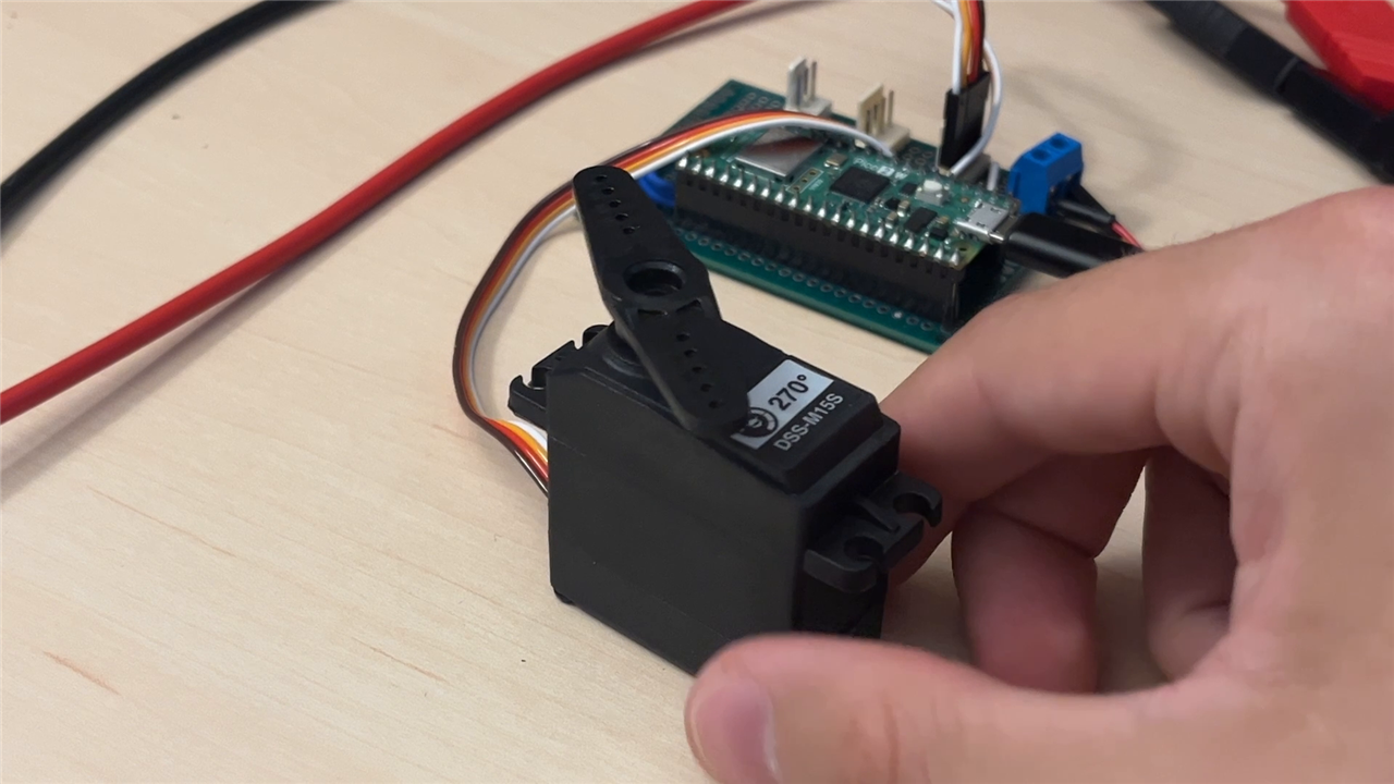

Three servo motors are used. Two control the primary arm joints while the third operates the pen-lift mechanism.
Rather than using stepper motors or brushless motors with dedicated drivers, Milos chose standard RC servos because they are inexpensive, easy to source and straightforward to control.
“Why not use stepper motors or BLDC motors? One thing, simplicity.”
Two of the servos also provide analogue feedback signals. These are connected directly to the Pico's ADC inputs, allowing the software to monitor actual joint movement and compare commanded positions with measured positions.
“This is just an additional line that will feed the Pico ADC so we can measure the actual angle and get some graphs back.”

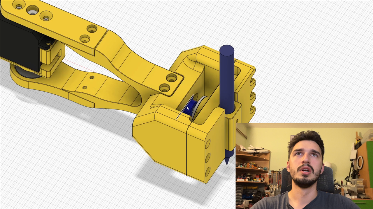

Mechanically, the arm was designed in Fusion 360 and printed in PLA. The design uses two equal-length links measuring 150mm each.
“Both links are at 150 millimeters which was my goal so we can keep them as easy as possible.”
The drawing mechanism is equally simple. An SG90 servo lifts and lowers a pen through a small cam arrangement, enabling the robot to trace paths onto paper.
All CAD resources, including STEP and STL files, are available for builders wishing to recreate or modify the project.

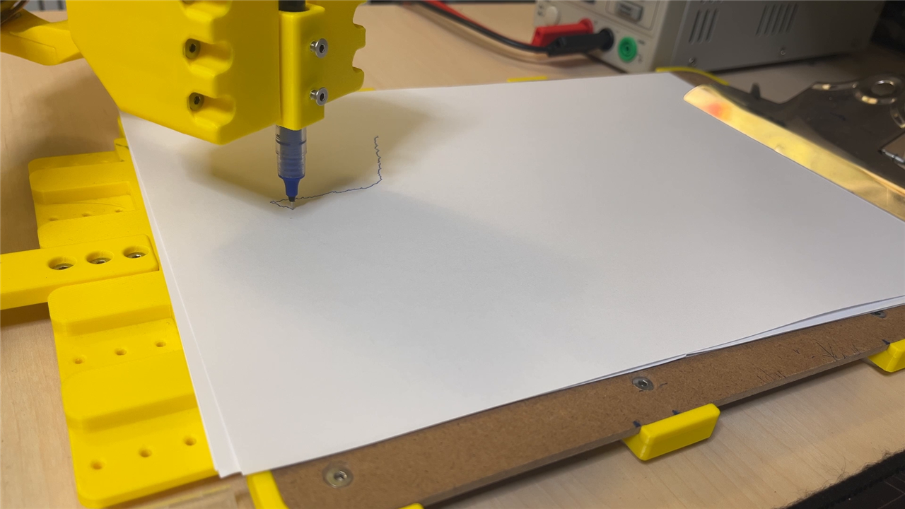

Drawing Paths with CSV Trajectories
Once direct control was working, the next challenge was creating repeatable motion.
The GUI includes a path playback system capable of loading CSV files containing coordinate lists.
“We can load up a custom CSV with a bunch of points to which the robot arm should go and we can trace different outlines.”
To simplify shape creation, Milos also created Python tools capable of generating geometric paths automatically.
“It generates your CSV shape in a bunch of dots and when you load that in the graphical user interface your arm will actually replay that path.”
This transforms the robot from a coordinate demonstration into a machine capable of producing recognisable drawings.

As expected, the limitations of hobby-grade servos quickly became apparent.
“The arm moves a lot and that's the main issue with servos like this, they just aren't that accurate.”
However, the educational value remained high.
“For the price and for the simplicity of how easy they are to use they are a pretty good deal.”
Path playback tests produced some impressive results, including stars and even an element14 logo. Although the robot occasionally exhibited visible oscillation, Milos identified exactly why:
“It actually stops between each point so it's not as accurate as it could be.”
Future improvements could incorporate more advanced path-planning methods and look-ahead algorithms to smooth motion between waypoints.
“You can do this much better with proper path planning look forward algorithms that would make the actual path for both the servos smooth.”
