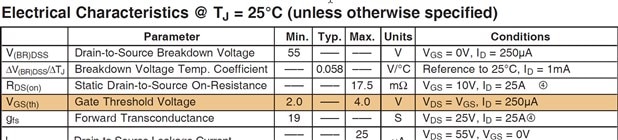

Figure 2 - IRFZ44N's Vgs-threshold range
Figure 2 shows the IRFZ44N's Vgs-th. Notice how it is a range from 2.0 to 4.0 volts. Do not make a mistake pre-bald engineer made many years ago. This value is not the operational range for Vgs. This range is telling you anything above 4.0 volts guarantees a MOSFET is ON and anything below 2.0 guarantees the MOSFET is OFF. A voltage in-between may or may not turn on the MOSFET. But. There is even more to the explanation of the threshold voltage.

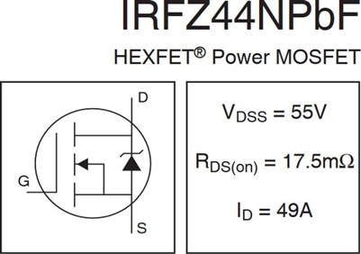

Figure 3 - IRFZ44N Datasheet Header showing (minimum) Rds-ON
The first page of the IRFZ44N's datasheet says the Rds-ON is 17.5 mOhm. Well, that was easy! Or was it? First, let me address the tiny amount. Someone asked me once: "Isn't 17.5 milliohms practically 0 ohms?" Well, no. No, it is not. Not only that, but the resistance from drain-to-source varies under a variety of conditions! Including, the applied voltage from the gate to the source (Vgs).

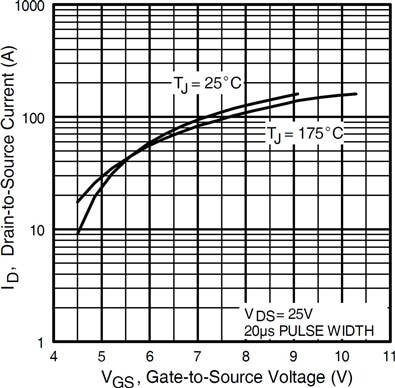

Transfer Characteristics
Compared to the other stuff in the datasheet, the transfer characteristics graph is easy to read. It contains the drain current for when applying a specific voltage to the gate. Take note that this graph starts at 4.0 volts, which was the maximum value stated in the electrical specifications table.
Figure 4- Transfer Characteristics
To me, this graph is a quick way to see whether or not you need a driver for a particular MOSFET. If I were driving the IRFZ44 from a 3.3 volt microcontroller, and my load required at least 10 amps, I would be using a driver to increase the gate voltage. While 4 volts is enough to turn on this particular MOSFET, its on-resistance is going to be (relatively) high.

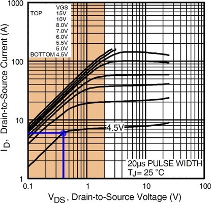

Output (On-Region) Characteristics

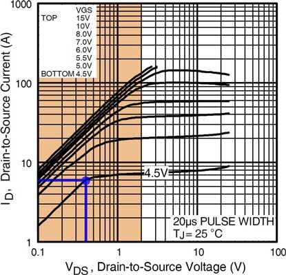

The output characteristics graph looks busy. But there is a ton of useful information packed into it. It shows the voltage drop across Vds, based on the amount of current going through the drain, which is also based on the Vgs voltage. There is an additional detail available.
Figure 5 - Output Characteristics
The orange section of the graph shows the linear operating region. The condition shown is the ideal "area" to operate a MOSFET when used as a switch.
RdsON=VdsId =400mV6A =66.67mOhm
You can use Ohm's law to find the resistance with a known voltage and a known current. Since this graph shows the drain-to-source voltage (Vds) at a certain drain current (Id), it contains the on-resistance (Rds-ON). The blue line shows at 4.5V, the Rds-ON for the MOSFET will be 66 milliohms.

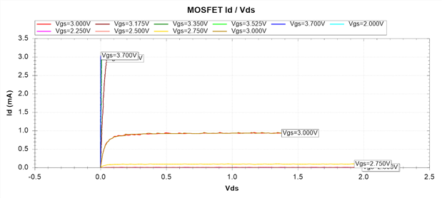

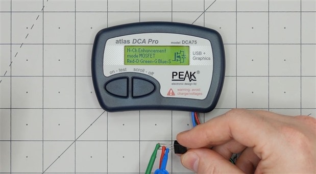

Recently, the element14 community sent me a DCA Pro from PEAK Electronics. It is a semiconductor analyzer. (Previously I wrote about the ESR70, which measures capacitance and ESR.) This small portable device runs about 150 USD. For a wide range of semiconductors, it can determine pinouts, measure key characteristics, AND draw parameter curves. It works with didoes, zeners, LEDs, BJTs, MOSFETs, IGBTs, JFETs, SCRs, Triacs, and EVEN voltage regulators. (Really!)

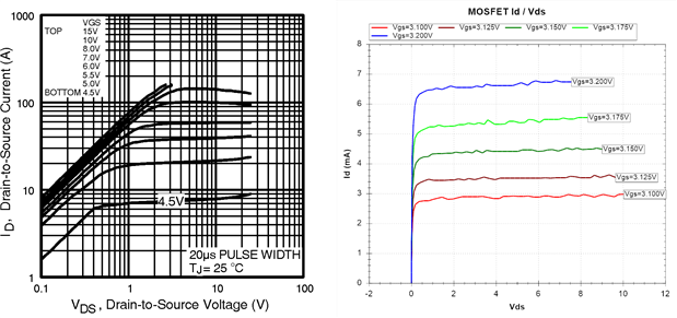

Determining pinouts and testing components is the primary reason to get the DCA Pro. There is a bit of an issue with the curve tracing. Look at Figure 6, which is comparing the output characteristics graph from the datasheet and the DCA pro, side-by-side. Notice how their shapes are quite a bit different. Both graphs have the same axes titles, and both have multiple Vgs lines. However, that's the only similarities. But why?
Figure 6 - Output Characterization Comparison
The reason is the limited current of the DCA Pro. It can only drive a few milliamps, up to 10-12 mA, through the drain. Let's combine that fact with three points from this post:
  1. This graph shows the voltage drop from drain to source.
  2. The Vgs voltage sets the resistance between drain and source.
  3. MOSFETs obey Ohm's Law when operating in their linear region.
Since our semiconductor analyzer can only source 10 milliamps, the measured Vds is significantly limited. In the case of this IRFZ44, we are comparing drain currents of milliamps to amps. So the displayed data is correct but seems off. (Also, the datasheet is using a logarithmic scale while the DCA Pro software uses linear scaling.) Does this comparison mean the DCA Pro is worthless for measuring power semiconductors? No, not at all. I very much like the DCA Pro and think it is worth its price. Just do not expect it to replace a $10,000 curve tracer.

If you're interested in learning more about the device, check out my full video review. In the video, I compare how it performs with a variety of semiconductors. I was happy to see that it could correctly identify components like an N-Channel Depletion Mode MOSFET. You can also see the DCA Pro software in action. Over on the Workbench Wednesday's post, I have a zip file with example data from components I measured that you can use in PEAK's software.
Conclusion
As a standalone device, the DCA Pro is already fantastic. As a curve tracer, it is better for low power devices like diodes. However, even for large current transistors, it can still hint at a transistor's performance. With the sweep in Figure 7, look at how this transistor follows the min and max Vgs thresholds from the datasheet. Right at 3.00 volts, Vgs is just high enough to turn on the MOSFET barely. At 2.75 and below, the MOSFET Is entirely off. At 3.175V and higher, it turns on. Just like the datasheet says. Pretty cool, huh?
