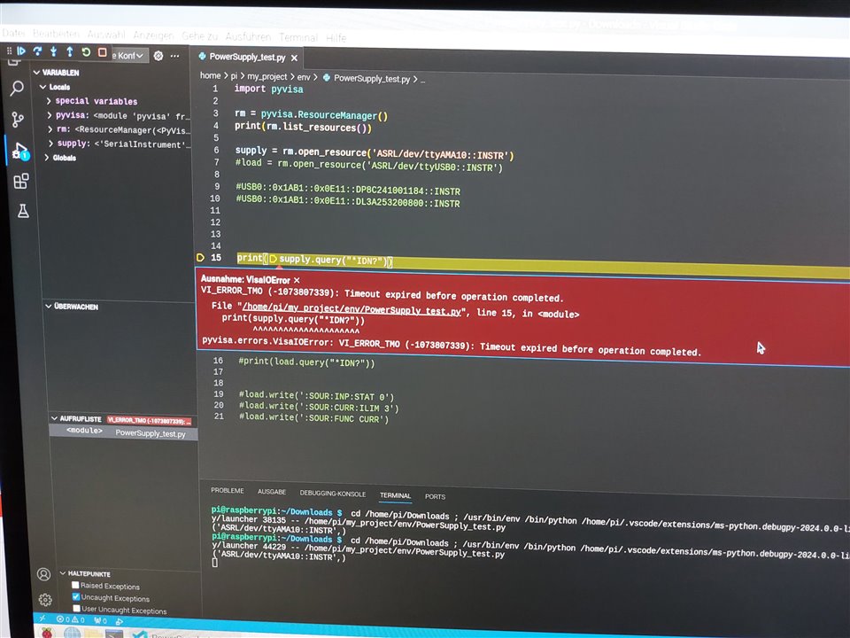

  • zack_el
    zack_el over 2 years ago in reply to baldengineer
    I tried to control both devices (DL3021 and DP832) via the USB interface, but I always receive the following error message:
    Exception: VisaIOError VI_ERROR_TMO (-1073807339): Timeout expired before operation completed. In the file "/home/pi/my_project/env/PowerSupply_test.py", line 15, in <module>
    print(supply.query("*IDN?"))
    ^^^^^^^^^^^^^^^^^^^^^ pyvisa.errors.VisaIOError: VI_ERROR_TMO (-1073807339): Timeout expired before operation completed.image
  • baldengineer
    baldengineer over 2 years ago in reply to zack_el
    So keep in mind that a driver for the device and the "VISA driver" are separate things. The VISA driver talks to the OS drivers. So,if the OS cannot enumerate a device and provide a handle, then the VISA driver doesn't matter. So, this is not a NI-VISA issue.
    Regardless, I am fairly certain Rigol uses either a libusb-based interface or emulates a USB-Serial device when connected by USB for all of their devices. I have never encountered one that does not work with Linux.
    Compare the output of lsusb and what the pyvisa resource manager finds to verify what is getting enumerated.
    Also, the R&S VISA drivers work great on Raspberry Pi. I've found their driver worked slightly better than pyvisa-py, regardless of the vendor's instrument.
  • zack_el
    zack_el over 2 years ago in reply to zack_el
    I was able to communicate with the RIGOL DL3021 using the RS232 interface and program it with the Raspberry Pi 5 and Python. Unfortunately, it does not work over the USB interface because the Raspberry Pi cannot identify the instrument.
