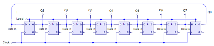

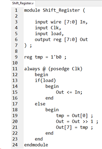

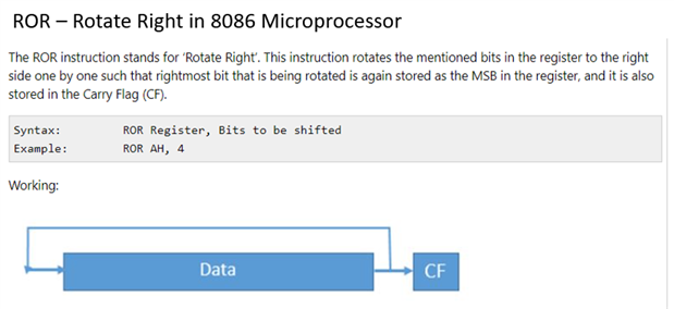

Sequential Logic: The Shift Registers

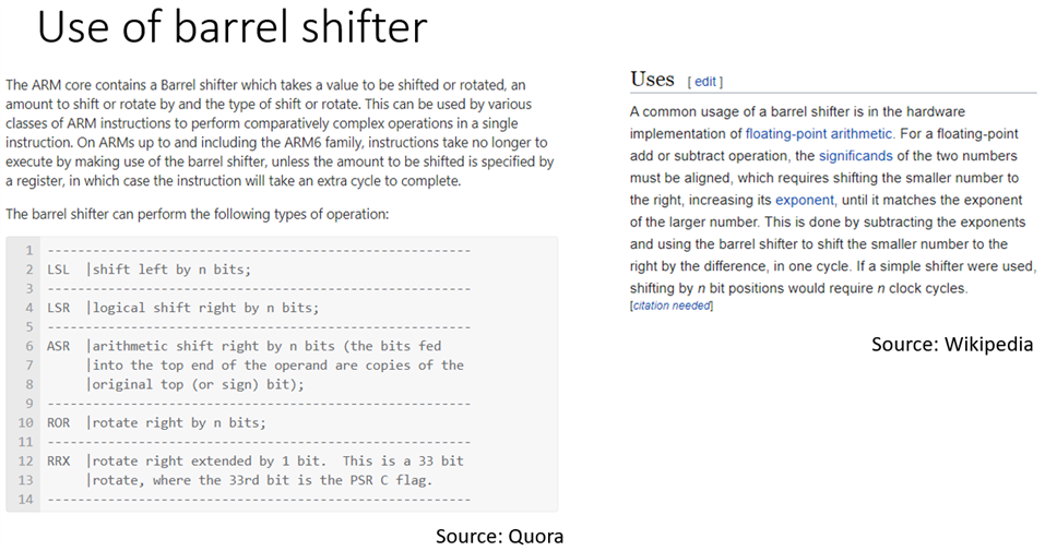

We all know what shift registers are, and why they are used - to shift bits in a register right?
But the applications inside a CPU or Microcontroller are vast and play a crucial role in Arithmetic and Logic Units especially in ARM Processors these days.
The design given below is specific to shift right. But why? This operation was used in the vintage 8086 microprocessor to implement the ROR instruction.
8-bit Shift Registers Design:
Verilog Implementation:

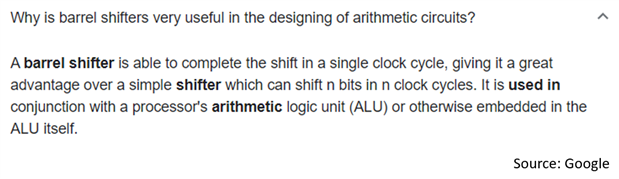

Is there any other way to shift the bits?
- Yes, the barrel shifter.

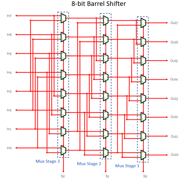

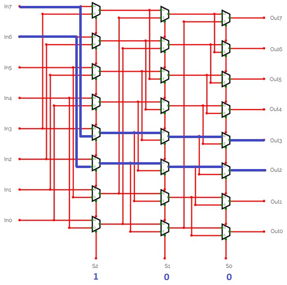

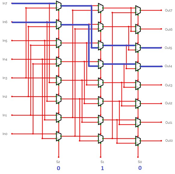

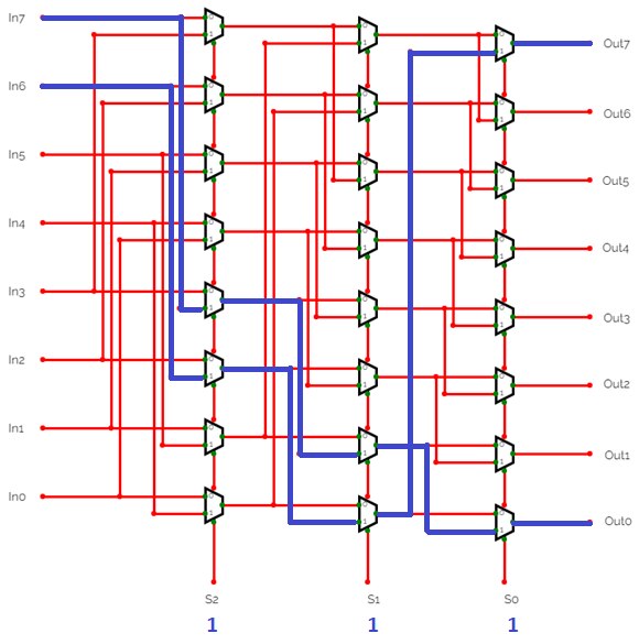

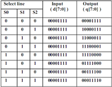

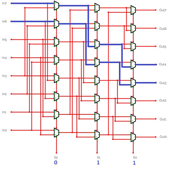

Combinational Logic: The Barrel Shifter
Truth Table:
In this blog, I'm going to discuss the design and implementation of 8-bit barrel shifters using Multiplexers.
The modeling I'm going to follow is Structural design in Verilog HDL.

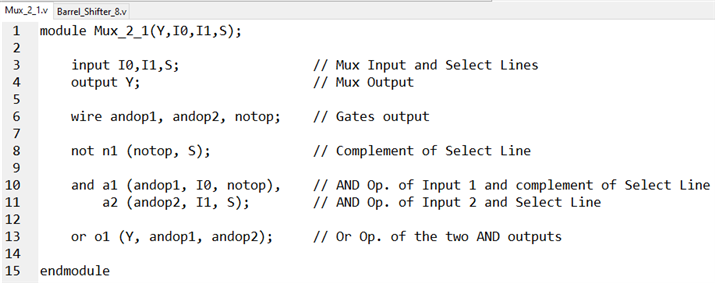

First of all, to get started let's design a 2:1 Mux
Verilog code for the 2:1 Mux in structural model is pretty simple, we have 2 AND Gates, 1 NOT Gate, and 1 OR Gate.
Apart from regular inputs and outputs, three wires are declared for the gate outputs and are connected according to the structure.

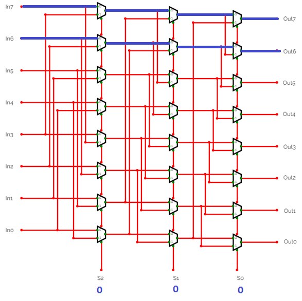

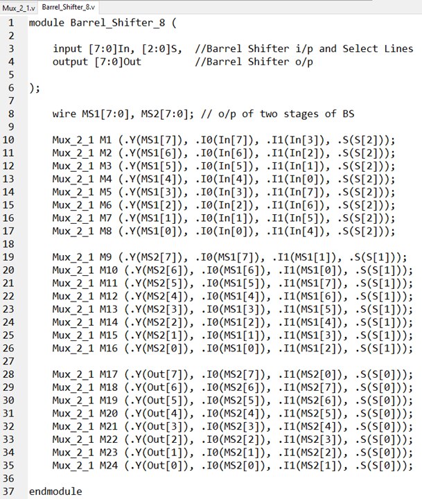

Design of 8-bit Barrel Shifter:
By using the structural design, we can make sure the design is implemented in the way we want it to be.

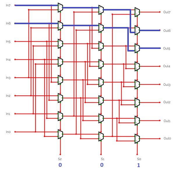

Working of Barrel Shifter :
{gallery} BS
No Shift
Shift by 1 bit (001)
Shift by 2 bits (010)
Shift by 4 bits (100)
Shift by 3 bits (011)
Shift by 7 bits (111)
This is how the barrel shifter shifts the bits according to the select lines.

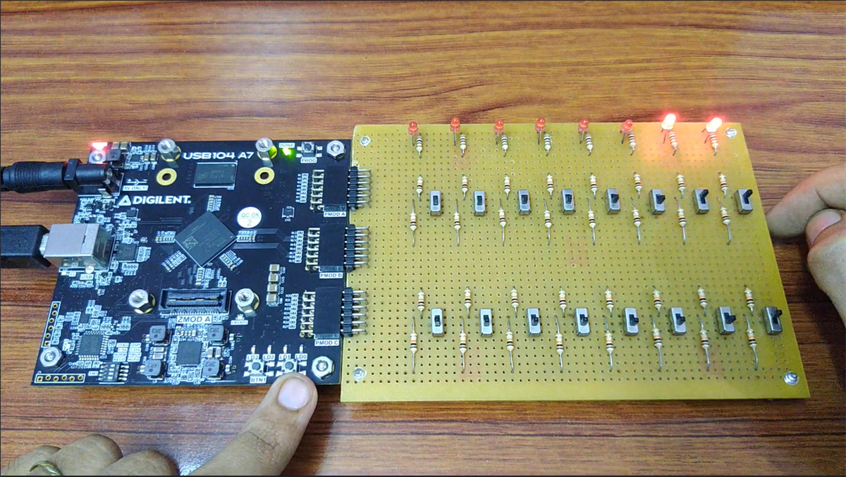

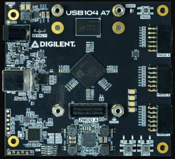

Implementation on Artix-7 FPGA:
I will be using the USB104-A7 FPGA Development Board for the implementation. This was road-tested a few months back. Read the review here: USB104 A7: Artix-7 FPGA Development Board - Review

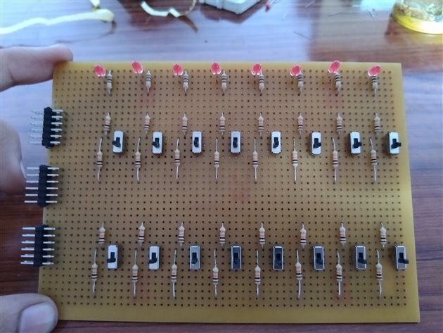

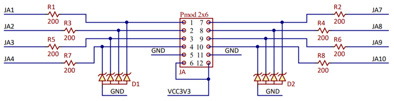

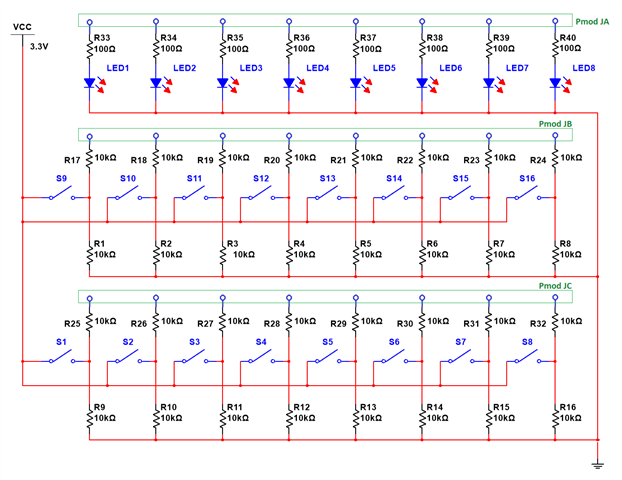

Fabrication of custom Pmod:
A custom Pmod (Peripheral Module) was to be fabricated for implementing digital designs as there was very few user I/O peripherals such as push buttons and LEDs.

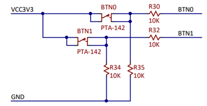

Let's take a look at the schematic for the fabrication.
image         image
Design made with NI Multisim:
From the schematics, it can be understood that using a 10k resistor would be used for pull-up and pull-down purposes.
As there is already a 200 Ohm resistor connected in series to the Pmod GPIO to prevent damage to the FPGA if one accidentally drives an input as an output,
only 100 Ohm resistor is used in series with the LEDs. All switches are active high. The circuit diagram is given below:
image   image

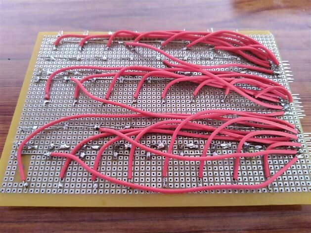

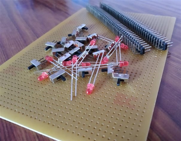

Started with the above components, some PCB mount slide switches, LEDs, and the Bent Male-Male Dual pin headers.
After soldering all the components and the connections:
                                                            Front - end                                                                                                                                   Back-endimage   image

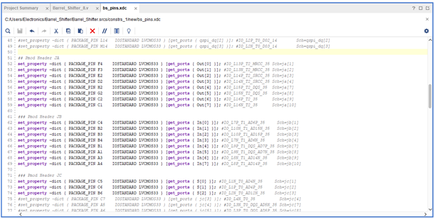

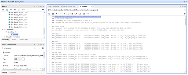

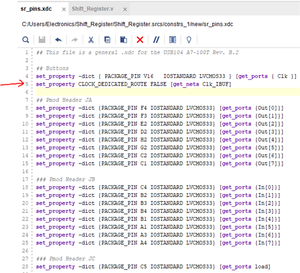

Here is the general constraints file for the above-fabricated Pmod:

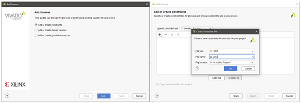

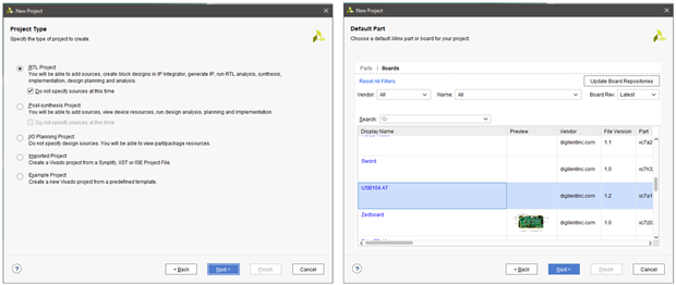

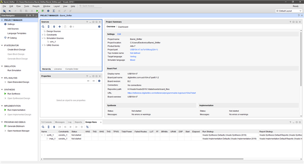

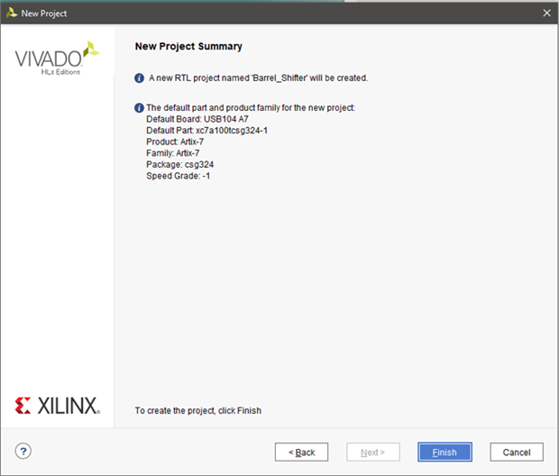

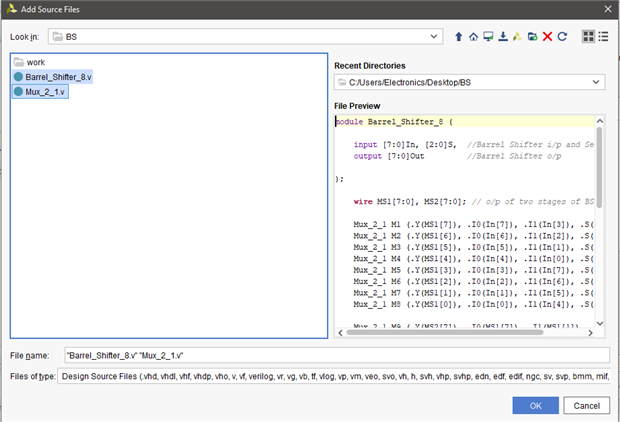

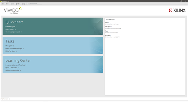

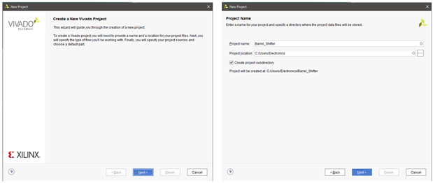

Getting Started with Vivado:
{gallery} Vivado
Create new project
Give the project a name without spaces
Choose the board
Finish

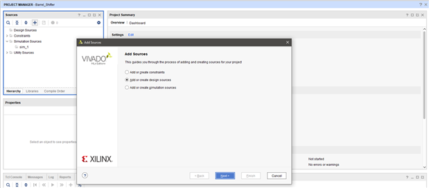

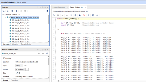

Click on add new sources
Select the files required
You will see the instances on the left panel
Add the constraints file
Give the exact constraints name

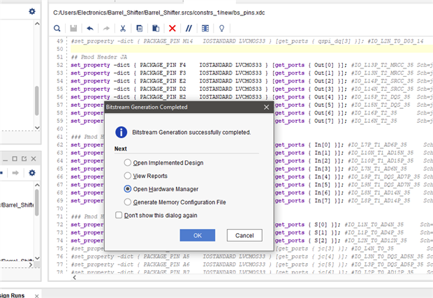

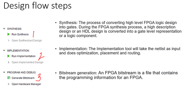

Regular Design flow
Make sure to add a command in the constraints file of the shift register project if you're planning to use the push button on the FPGA board as the implementation won't complete due to a clock dedicated route error.

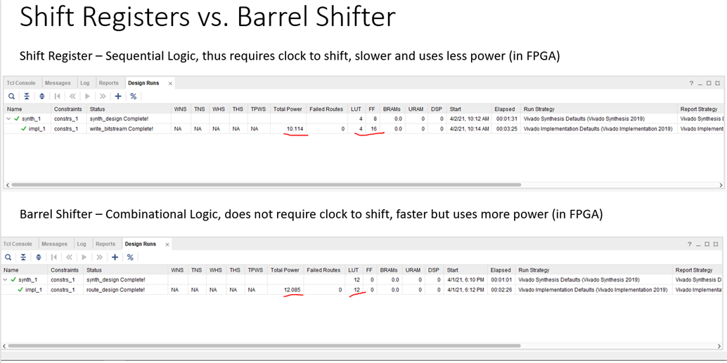

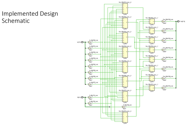

8-bit Shift Register on Artix-7 FPGA:
8-bit Barrel Shifter on Artix-7 FPGA:

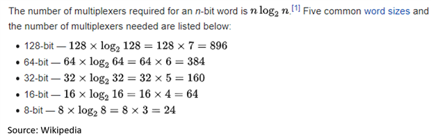

Final Comparison after implementation:
