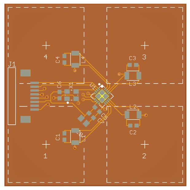

    Just as an update, to turn this project into something more usable, I've gone ahead with designing PCBs for it. I've gone with a dual-PCB option. The first board contains the four touch-less sensor areas…

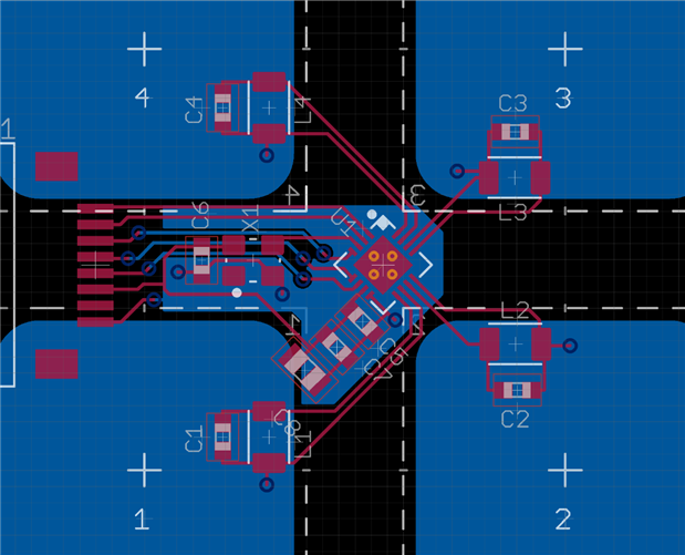

    I figured I'd try to squeeze it between the sense pads.. It's still 2-layer, and is now a 48 x 48 mm board.
    No idea if it will perform as well, but I think it is worth a try.

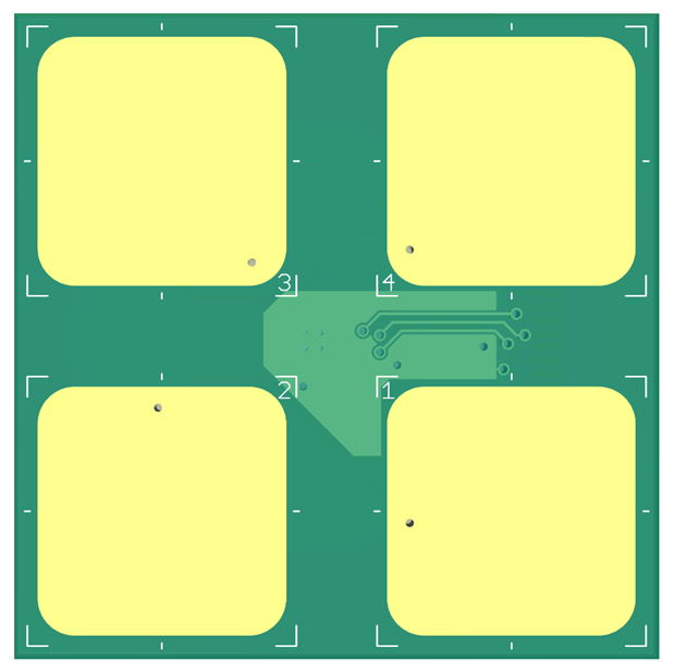

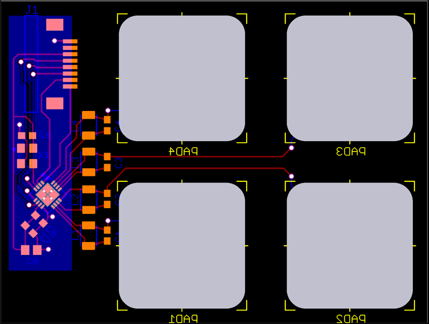

    Here's a first draft of a potential PCB for it.. the idea being that the microcontroller board is separate, so it can control (say) up to four of these, for a total of 16 sensors.
    I thought about a hole in each pad, or holes (e.g. small perforations), for a light indicator. Maybe that's not necessary for a first version, and any feedback can be via a display or speaker on the microcontroller board.
    All the parts are surface-mount, so the other side is flat, with the pads etched on that flat side, so the board could be taped or glued behind a plastic or glass panel.
    In theory, with a 4-layer board, I could perhaps have the circuitry directly on the pads, and reduce the PCB size and make it more versatile. The added capacitance of the inner ground plane should not cause much of an impact since it is a static additional capacitance. But I don't really know for sure since I have not tried it. Since I'm not envisioning being restricted for space, I figured I could just have the circuitry to the side for now, with a 2-layer board.
    Any ideas or suggestions are welcome.
