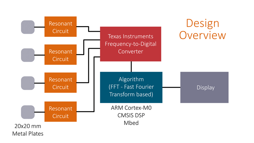

The heart of the system is an FDC2214 Capacitance to Digital Converter part from Texas Instruments which can measure capacitance at an extremely high resolution. The capacitor-under-test is assembled into a resonant circuit using a parallel inductor, and the TI chip measures the oscillation frequency. If the capacitance changes then the frequency changes. The TI chip is connected to a microcontroller which can read the frequency (and therefore indirectly the capacitance) for up to four resonant circuits, and it can take measurements hundreds of times a second.
In order to bring the human user into the system, the capacitance needs to be modified in some way as the user attempts to air-touch a virtual button. I decided to implement a ‘self capacitance’ method, whereby one end of the resonant circuit is attached to a metal plate. A nearby human finger will create a capacitance with the body, and the body will have a capacitance to ground. Similarly the metal plate will have some capacitance to ground. The change in capacitance due to the finger presence will be small, but measurable. With traditional capacitive touch sensors the measurement method isn’t as granular or low-noise, however the resonant circuit frequency measurement method is! The presence of a finger should cause a noticeable difference to occur in the measured capacitance even at some distance away.
The next step was to figure out how to use the raw readings to detect air-taps. I decided to use an ARM DSP library to perform a fast fourier transform (FFT) on the stream of capacitance measurements.  The FFT procedure is used to extract frequency components present in the incoming stream of data values. The result of this is a set of frequency-related buckets. By using the contents of a bucket, the system can be used as kind of a filter, to remove constant or slow-changing capacitance values from the analysis. This was great – now the system could more reliably detect the rapid motion of a hand moving toward or away from the metal plate! It would also near-eliminate all construction issues, since capacitance changes are output from the algorithm, not static values that would be related to how the project was built or where it was physically located.
Another problem was how to know which button was being pressed, since all of the sensors will detect a capacitance change from a distance. That was easy to solve by comparing the bucket value across all of the sensors and choosing the largest one.
Finally I needed to decide on the data sampling rate, which is configurable with the Texas Instruments chip; at higher sample rates the measurements are less granular, but on the other hand a lower sampling rate means that I cannot distinguish fast hand movements. I experimented a little with the values until I was happy with the result.

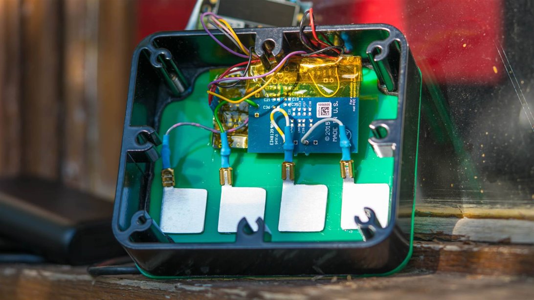

I used guesswork to find suitable capacitor plate sizes. I went with 20x20 mm aluminium plates, each separated from the other by 6mm. That means that each button center is 26 mm from the next button center. That’s not much more than existing typical outdoor push-buttons, so I think the solution could be retrofitted. To test that, I looked up an outdoor keypad with a 4x3 matrix – it had buttons separated by 19 mm. Since I wanted to try as realistic a setting as I could manage, the demonstrator model was built using an existing outdoor keypad enclosure (intended for 4x3 outdoor keypads) made of metal. The front panel was 3mm thick acrylic sheet. I used a reflective LCD screen since that would be visible outdoors, although it would need a protective clear cover.
A practical design might use shapes etched in copper on a PCB, but I used aluminium plate for now, so I could move them around if I got the separation or sizes guessed wrong.
For the microcontroller board, I used an old Freescale/NXP FRDM-KL25ZFRDM-KL25Z board, but nearly any ARM Cortex-M chip could be used, since that FRDM board has a basic Cortex-M0 and not a lot of resources.

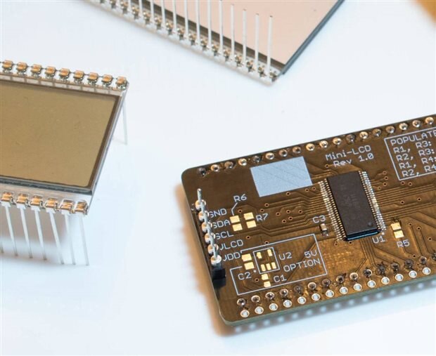

The LCD screen was an earlier project: Building a 3.5 Digit Low Power LCD Module . It uses a piece of LCD glass from Aliexpress, combined with an I2C LCD driver chip from NXP. I’ve built up several of these displays, they come in handy for prototypes. I decided to make half a dozen of these at a time (to save on shipping costs), it then costs less than £5 (approx $7 USD) each.

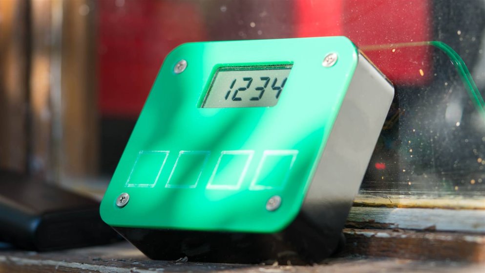

Although not a lot of testing has been done so far, I did want to try it outdoors, just to confirm that it could operate in an example environment where existing outdoor buttons could be required. I propped it up at a suitable height on a window ledge, although in reality it may be screwed to a wall, and tested using a USB power bank. I also tested indoors, powered from a USB phone charger, and from a laptop USB supply. It seems to behave itself, although I’m sure it could be fine-tweaked further to suit specific applications. The video at the top of this blog post shows the outdoor result.

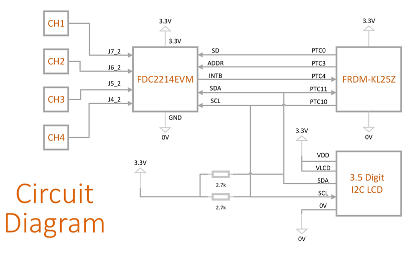

If you would like to build this project too, the circuit diagram showing the connections between the boards is shown in the blog post. The source code is available on github. Follow the steps here to program the board: Working with FRDM Boards and ARM mbed
