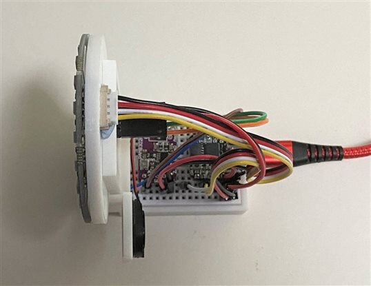

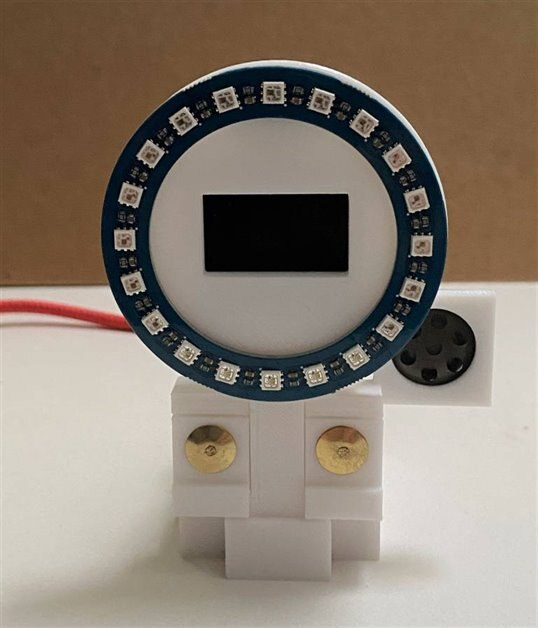

This will be my final post for the Holiday Special 20 project.  I was able to accomplish much of what I had planned, but failed to get the Christmas music to play from the external flash memory on the QT Py.  I'll use this post to describe the problems that I had and to summarize the project.  And I'll do a demo video.
Here are a couple of pictures of the completed construction (front and top view) which show the addition of the audio amplifier and speaker:
SamdAudio library problems
I had chosen to use the SamdAudio library because it supports playing WAV audio files from both SD card and external flash memory using a SAMD21 MCU.  I demonstrated in a previous post playing WAV audio from SD card on a Xiao Expansion board and in the following post I demonstrated loading and accessing a WAV file in the external flash memory on the QT Py.  So, all that remained was to add the library and play the audio from the flash memory.
Unfortunately, the devil is always in the details and I could not get the playback to work.  The first problem that I encountered was that the SamdAudio library was last updated about 2 years ago and it is no longer compatible with the current Adafruit SPIFlash library and it was trying to include files that no longer exist, so the program would not compile.  I thought about trying to find the earlier version of the Adafruit library that it used, but I found that others had encountered this problem and there was a forked version of the SamdAudio library that was updated to work with the new SPIFlash library (the SD part of the old library still works).   The new library is the Audio_FeatherM0 which was used on the Adafruit FeatherM0 (also uses a SAMD21 variant).
With the Audio_FeatherM0 library the program compiled and it could find the WAV file in the flash memory, but the playback did not work.  The audio library is non-blocking, which it achieves by using timers and interrupts for reading the flash memory and writing to the DAC.  The good news and bad news is that the SAMD MCUs have highly configurable timer/counters.  The bad news part is that there are a lot of registers that you need to get right to make a timer/counter work correctly (clock source, pre-scaler, output multiplexer, etc.).  Since this library has worked with other SAMD21s, the most likely issue is that there is a resource conflict with the clock that is being used for the timer/counter.  I tried a few different clocks, but I couldn't get it to work.  I'm reasonably confident that the flash memory read is working, but I'll need to defer the debug until I understand the SAMD21 better.
Sort of working demo
I decided that I would put together a demo of how it should have worked.  I'm going to use the Xiao Expansion board to play the music, but I'll trigger an interrupt to that board from the second cap sense button on the QT Py.
Everything almost worked image....
