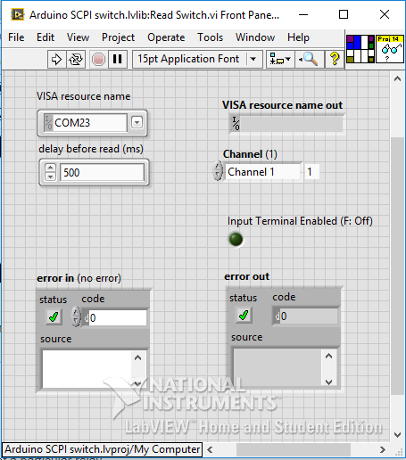

This is a data block. You ask the Arduino what the status is of a particular relay.
This block accepts two parameters and returns one value:
  • Channel (1|2): the relay that will be controlled by this block
  • Read Delay (ms): how long do we wait for the Arduino to answer.
  • Enabled (true|false): status of the particular relay.

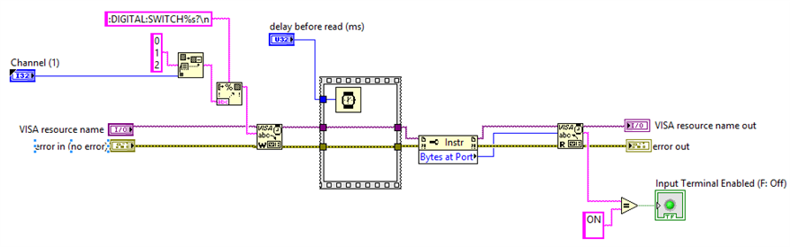

The flow is comparable to the previous one, except that we use a different SCPI command and that we add a data read block.
The left part prepares the SCPI command. Once it's constructed, it will be like this: :DIGITAL:SWITCH1?.
The middle block is a configurable wait. This should be set to allow the Arduino to verify the status and send the reply back.
The right side of the flow reads the status from the Arduino. Only when the reply is ON\n, we report TRUE. Else the block returns FALSE.

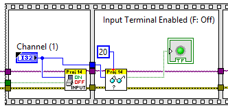

Here's an example that shows how to use the block:
