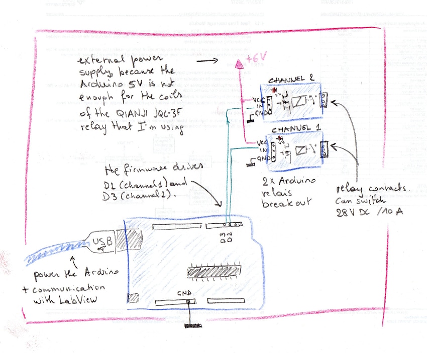

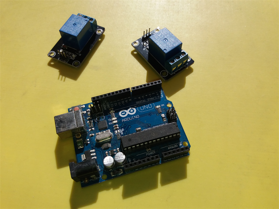

Hardware
I'll use an Arduino UNO and two relay breakout boards. I received the UNO from element14 to celebrate Project 14's birthday.
I got the two relay boards when I purchased the components from someone who was quitting the electronics hobby a few years ago.
Given that I have all components and that they are very simple, I don't expect any complexity on the electronics part.

I'll support the standard SCPI commands and dedicated ones to control both relays in the Arduino firmware.
Command Description Example
*IDN? instrument identity
*IDN?
Project14,Arduino SCPI Switch,1,0
*RST reset instrument. Set all switches off *RST
*CLS same as *RST *CLS
:DIGITAL:SWITCH# ON|OFF turn a switch on or off. 1 based :DIGI:SWIT1 ON
:DIGITAL:SWITCH#? get a switch' status. 1 based
:DIGITAL:SWITCH1?
OFF

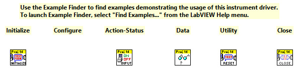

LabVIEW Library
details: Arduino in Test Instrumentation - Part 3a: LabVIEW Driver Intitialisation Block
details: Arduino in Test Instrumentation - Part 3b: LabVIEW Driver Switch Control Block
details: Arduino in Test Instrumentation - Part 3c: LabVIEW Driver Read Status Block

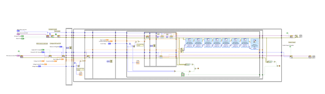

The end game is to include the Arduino switcher in the test setup I made for the RoadTest TI SWIFTTm Power Module EVM
Just as many instrument manufacturers do, I'll write a LabVIEW library with easy to use blocks: Init, Control and Close.
These blocks will make it easy to include the Arduino switcher into designs and it collaborate in an automated setup.
I'll claim success when I'm able to switch some configuration resistors in and out of my device under test to change its operation parameters.
If I can then run a test cycle It should be possible to capture the device's efficiency with 3 separate output voltage settings, with an input range sweeping from lowest to highest values, pulling between 0 and 7 A from the output.
In total this will be more than 2000 measurements that I'll have to capture.
