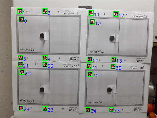

Four windows fully detected. Two closed (0% opening) and two open (30% and 4%)

Creating our virtual paper windows for testing
Print and cut:
Window ArUco Markers IDs:
Window Top Left Top Right Bottom Right Bottom Left Window Tracker
WINDOW 1 1 2 3 4 0
WINDOW 2 11 12 13 14 10
WINDOW 3 21 22 23 24 20
WINDOW 4 31 32 33 34 30
Using the paper window mock-ups to simulate 4 sliding windows
The different window parts are attached to the refrigerator door by magnets.
Raspberry Pi used for stop motion.
