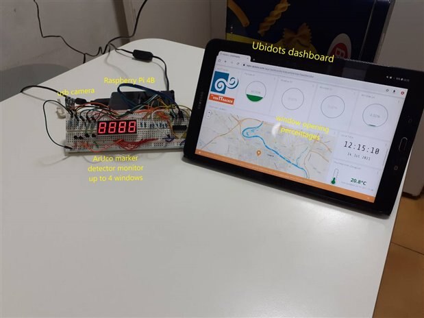

We finished our device to monitor the opening of windows. Our device allows to monitor up to 4 windows simultaneously. From its 4-digit 7-segment display, it allows you to monitor the reference markers of each of the four windows. And periodically the status of the four windows is published in the Ubidots cloud, allowing remote monitoring from the Venttracker dashboard.

Four windows fully detected. Two closed (0% opening) and two open (30% and 4%)

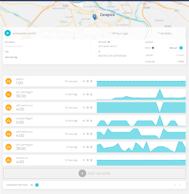

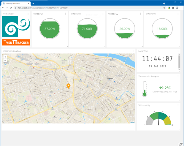

Connecting the device to the cloud
Ubidots
We'll be using Ubidots services with Ubidots free plan for STEM. This plan has some limits
  • First 3 devices free
  • Variables: Up to 10 variables per device.
  • Data Ingestion: 4,000 dots per day across all of your devices.
  • Data Extraction: 500,000 dots per day across all of your account
  • Data Rate: 1 request per second, across all of your devices.
  • Data Retention: 1 month.
We are using a 5 second refresh rate for the demos which exceeds the daily free dots cuota.

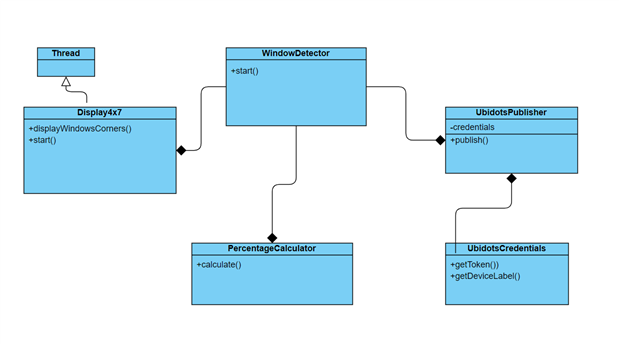

Class Diagram
You can inject in the WindowDetectector your own custom Display, Cloud Publisher or Percentage calculator object as needed.

Payload with geolocation and windows state
    'position': {
        'value': '1',
        'context': {
            'lat': '40.41902',
            'lng': '-2.92256',
            'serial_id': '10000000055eba52'
    'windows_no': 4,
    'w01_opening_pct': 87,
    'w02_opening_pct': 26,
    'w03_opening_pct': 71,
    'w04_opening_pct': 18
Ubidots Response. Request made properly and device updated
200
    'position': [{
            'status_code': 201
    'w01_opening_pct': [{
            'status_code': 201
    'w02_opening_pct': [{
            'status_code': 201
    'w03_opening_pct': [{
            'status_code': 201
    'w04_opening_pct': [{
            'status_code': 201
    'windows_no': [{
            'status_code': 201

WindowDetector Class. Python Code
Window detector. Detects up to 4 windows marked with 5 ArUco markers each
Results are sent to a 4x7 Led Display and published to Ubidots Cloud
Usage:
        windowDetector = WindowDetector()
        windowDetector.start()
Video images are captured in its own thread.
Last viewed marker positons are buffered.
Condition of marker detected uses a low pass filter using a deque that stores the 40 last states and compute as an or over the last 40 values.
This prevents the positions of the markers from being lost when one of the markers is momentarily covered over.
