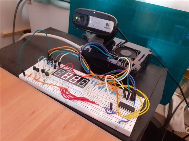

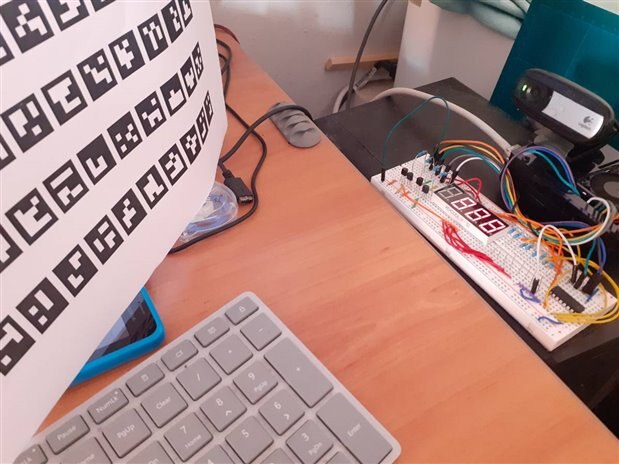

Our window opening monitor will not have a screen or graphic interface, so we need a means to be able to adjust the position of the sensor in the installation or on demand.
We have used a 4 digit 7 segment display to be able to monitor 4 windows at the same time. Each digit represents a window with its four corners and a moving part.
The detected marker corners are shown by turning on the LEDs corresponding to the same corner of the digit on the display. The middle segment represents the marker for the moving part of the window.

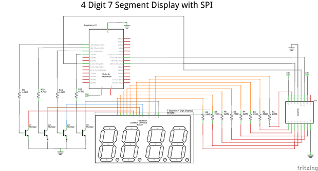

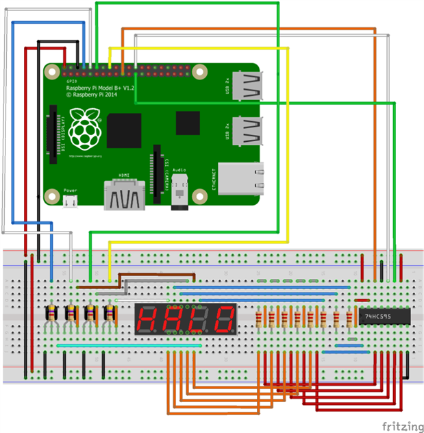

Schematic

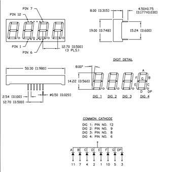

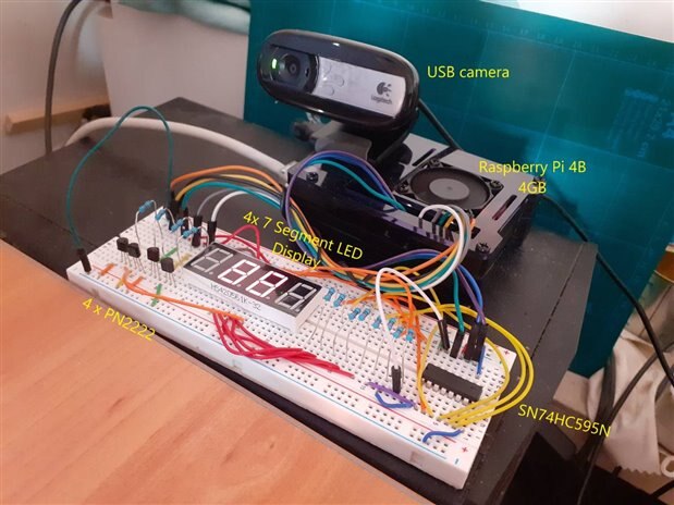

LDQ-N514RILDQ-N514RI 7 Segment LED Display
The LDQ-N514RILDQ-N514RI is a 0.56-inch quad digit 7-segment Display with 635mm red chip. Grey font/white segments. Common cathode
Multiplexed. We will use 4 Raspberry Pi digital outputs to select the digit. The four digital outputs are connected to 4 PN2222 transistors to drive the leds to ground.

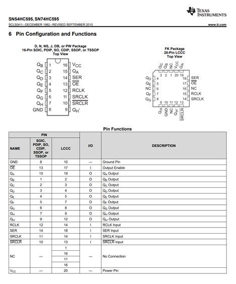

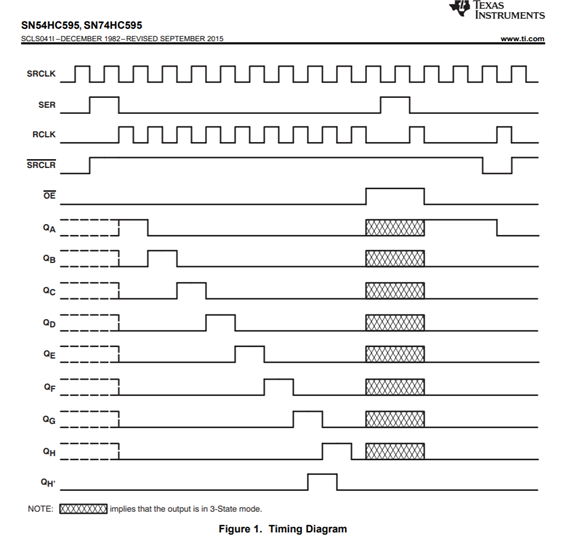

SN74HC595NSN74HC595N shift register
We will control send data to the display serially using the clocking of a Raspberry Pi SPI interface
How it works

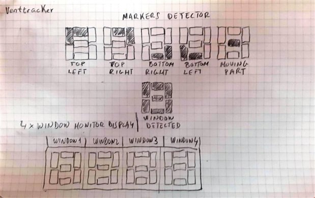

Windows 2 & 3 fully detected
Sheet with Windows ID 2 to 4.
Windows 2, 3 & 4 fully detected. Window 1 not detected
