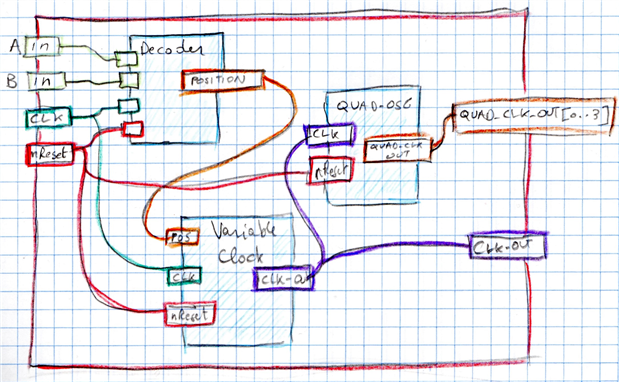

The design is broken up in 3 components:
  • decoder to translate the movements of a scroll wheel into a numeric value.
  • variable clock that will stretch the input clock based on the value coming out of the decoder
  • quadrature signal generator will create 4 90° phase-shifted signals from that variable clock.
A wrapper glues the components together.

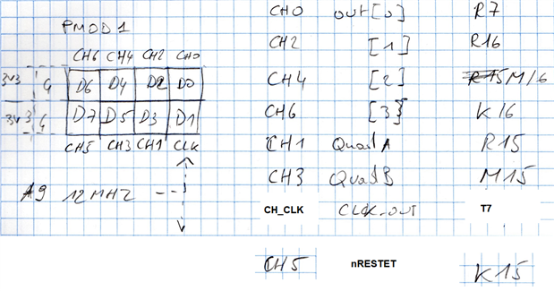

constraints.ucf
The external pins defined in quad_decode_quad_osc are mapped here.
I've mapped them for my specific board. Adapt for your FPGA/kit.
net clk_in                      loc=a9; # 12 MHz clock to FPGA.
net nReset_in                   loc=k15;
# PM1 connections for rotary encoder module.
net QuadA_in                    loc=r15;
net QuadB_in                    loc=m15;
# PM1 connections for the pwm outputs
net oscillator_quad_out[0]      loc=r7;
net oscillator_quad_out[1]      loc=r16;
net oscillator_quad_out[2]      loc=m16;
net oscillator_quad_out[3]      loc=k16;
net clk_out                     loc=t7;

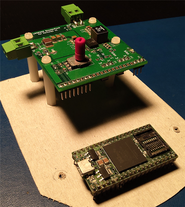

    It works on the Zynq too, but strange enough,
    only if I place the 3 individual blocks on the block diagram, and combine them there.
    If I put the wrapped design on the block diagram, it doesn't work.
    I'll retry from fresh tomorrow.
    This is how it looks like now (+ action video):
    edit: it works with the wrapper too. I made a typo and had assigned the reset of the quad generator to a rotary encoder pin.
    fixed and all ok now:

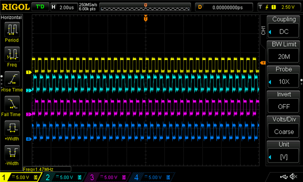

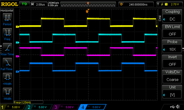

    Jan Cumps over 5 years ago in reply to Jan Cumps
    I'm testing it with the SDR. Look and feel is good.
    With a 60 MHz source clock at the moment. Because I know there's a channel to catch when I use that as the prime clock for the FPGA.
